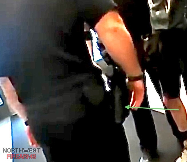

click for the big picture...arrow parallel to the path of the discharged round.
Wow just saw your post and you posted exactly the same stills as me and even used the same arrow. Sorry I wouldn't have posted if I saw yours. Great minds and all... ha ha!

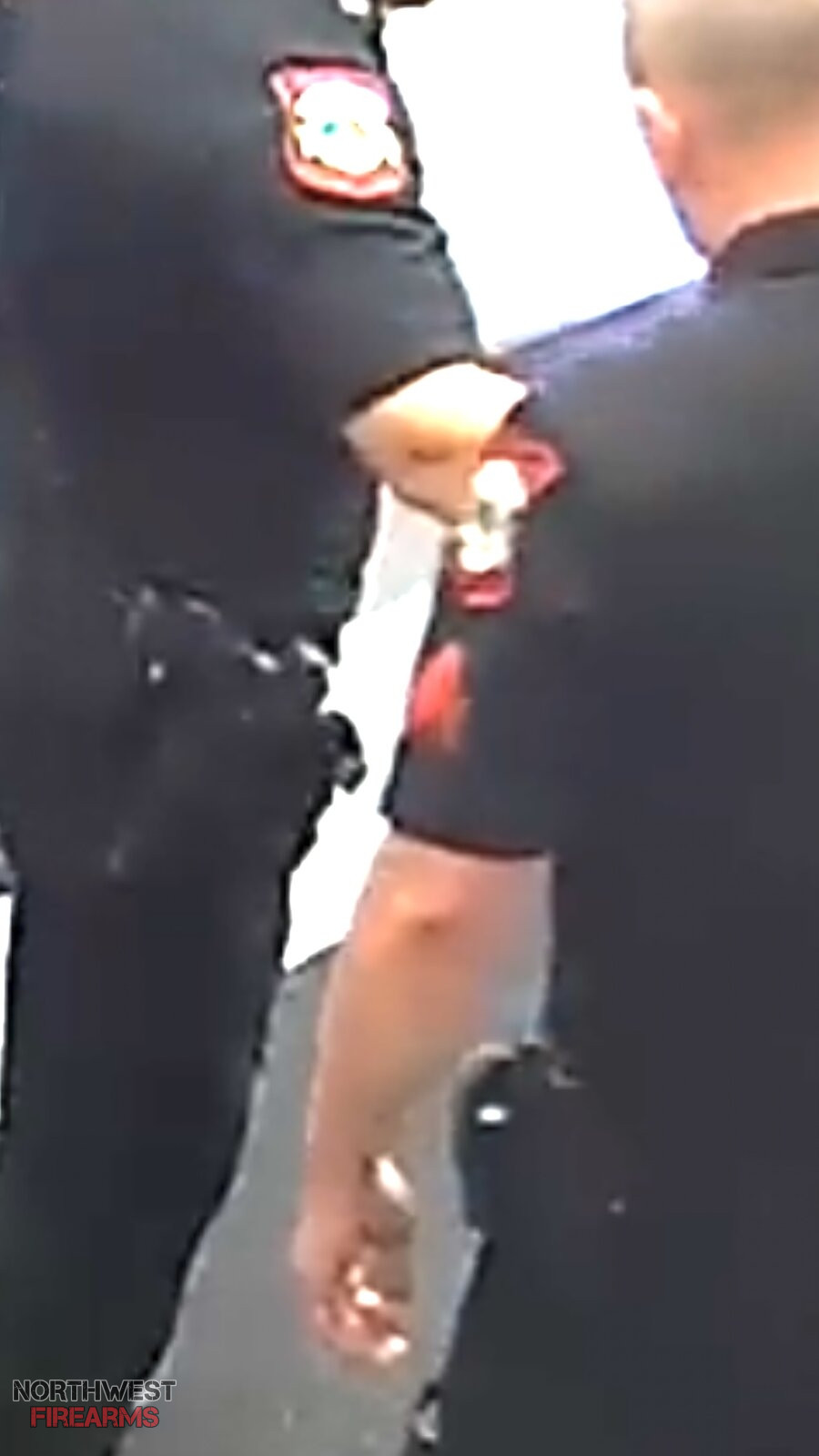

Can anybody tell what kind of holster that is? I'm having trouble getting a clear look. Basically I'm wondering whether is some type of nylon or if it's kidded or leather. If it's a soft type then leg could have hit trigger but I cant imagine a cop using that type of holster? One view shows that the holster has the gun set about 1" or more away from his hip. I'll try to find that screenshot.
Here is one that shows how gun is way far away from his body and at an angle. What holster is this I wonder? If this is a soft nylon type holster (for the part that is holding the gun, not the frame of the holster I mean) then one can't rule out that the trigger was hit by the leg. Extremely hard to tell but sort of looks like the portion surrounding the gun and trigger has a fold in it a bit, like it's soft nylon/elastic.
