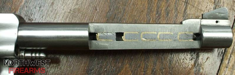

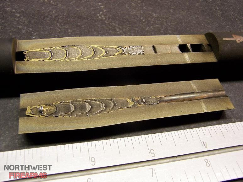

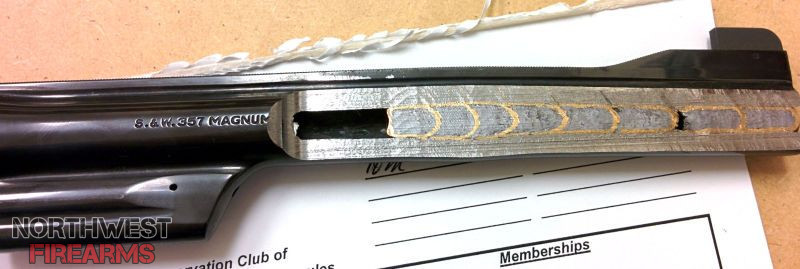

At saw that happen at a range once. One of our members had a new girlfriend after his wife died. She wasn't a gun person but I guess he wanted her to be. His thing was shotgun. So he left this woman on the pistol range while he went over to blast clay birds. He left her with his prized K38 six inch. He was also a buyer of abandoned storage lockers and this is where he got some of his ammo. Including what he gave this lady to use that day. She had the same experience, fired six rounds at a 7 yard target, couldn't see any holes. I was an RSO that day, was called over to her firing point to find six jacketed bullets stacked in the barrel nuts to butts. I never followed through to find out how that was rectified.
What method did you use to remove the stacked bullets?
I've seen people stick one bullet in a barrel. At this same range, I've seen people remove the bullet from a like live round, carefully chamber it so as not to spill any powder, then blow out the stuck bullet with the charge. I don't know if the sudden engagement of a bullet already seated in rifling does any harm but it worked when I've seen it done. Can't do it with six bullets.
The removal was equally 'Unpretty'. I put a long screw into a cleaning rod. Screwed into each one and pulled it out. It left noticable gouges on the rifling, but no change in accuracy.

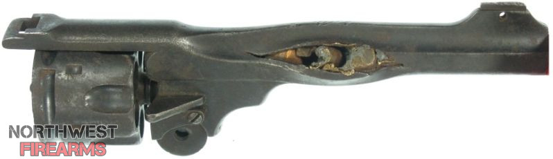

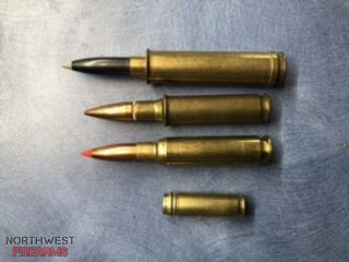

Years ago, I had a Smith & Wesson Hand Ejector in .32-20. It had a worn barrel and a huge cylinder gap. I had successfully fired jacketed bullets in .32-20 revolvers before. But they present a good deal more friction when fired down a rifled barrel. This old revolver had a six inch barrel. What with the very large cylinder gap, there just wasn't enough steam to propel the jacketed bullet out the long barrel. First shot fired, it sounded strange. I stopped shooting and of course there was the bullet stuck in the barrel. It was an old beater anyway so I wasn't too worried about any damage incurred by way of bullet removal. So I tapped the stuck bullet out with a steel rod and it left no marks. Don't know how this would work out with six stuck bullets stacked up against each other.
I've read in at least one reloading manual that caution should be used in shooting jacketed bullets in older revolvers with long barrels. For the reason I've stated above. "Back in the day," the only ammo available for these revolvers had lead bullets. They weren't designed for jacketed bullets with light or even medium charges. Not to say that it's never done now.
