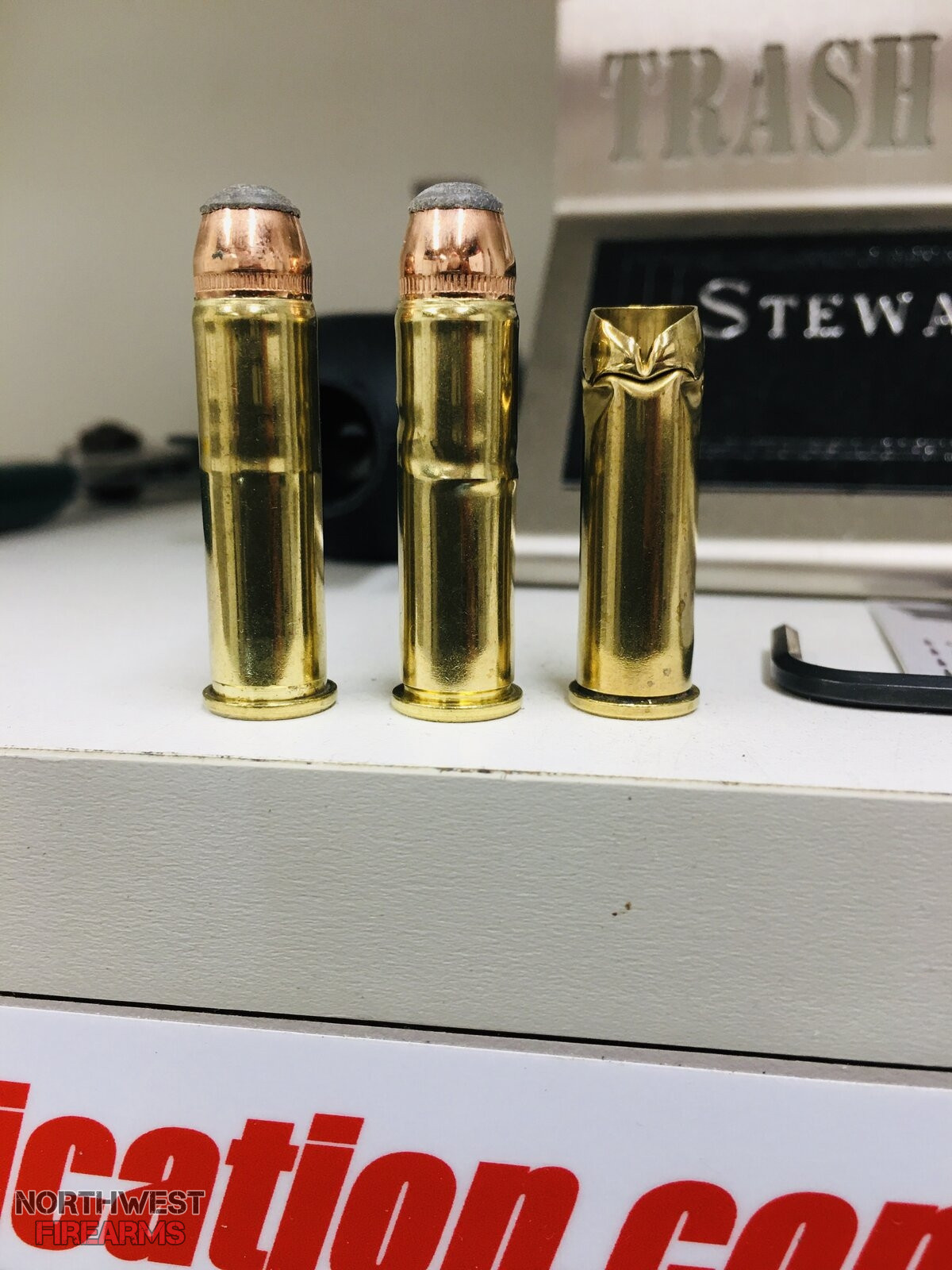

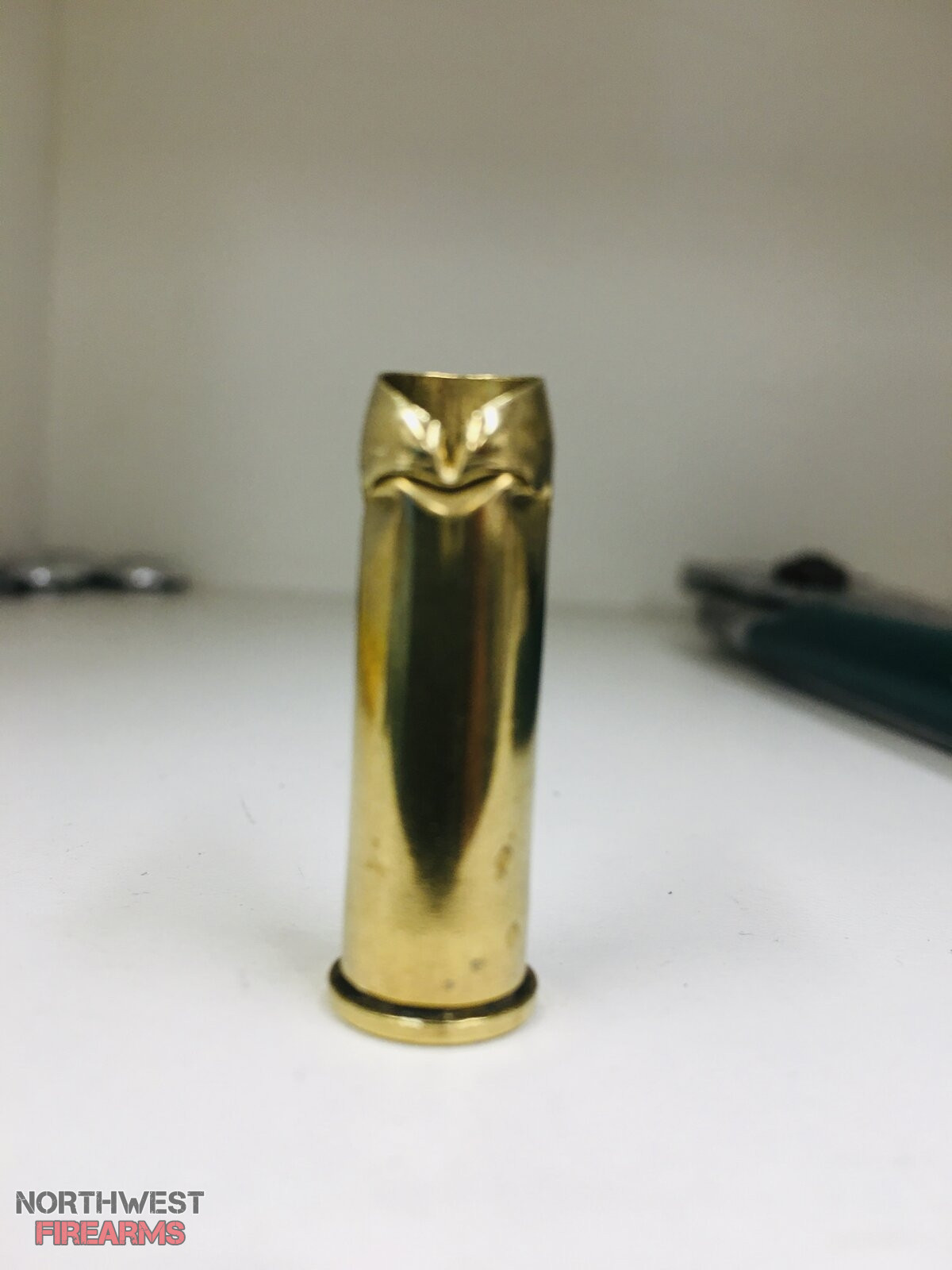

These were the first three that I attempted to load when I got back to the 357 loading session. I pulled all the dies, cleaned, reinstalled and adjusted and it ran fine after that. :s0125:
Meet the McGrumpy trio.
Projos the right diameter?
Did this happen on seating or crimp? I've seen combo seat/crimp dies do this if setup for 38spl when trying to run a 357mag through it without adjustment.
Whatever the problem was, it was certainly pushing down hard on that brass to get it to buckle.
Looks like the die was trying to crimp 38spl cases. If you were loading 357mag before this I would check your case and bullet length consistency
Die was definitely crimping too early. The crimped in place bullet couldn't move downwards so the soft point deformed and the brass buckled.

I believe it may have happened on the crimp due to the seating depth was too high.
You can see that the crimp is not in the cannelure. :s0092:
I had it setup for 357, took a few days break from loading and continued. Removing , cleaning and readjustment fixed the problem.
Have no idea more that what was mentioned, trying to crimp well before the bottom of the stroke. But I will say that those "Grumpy" rounds will look great sitting on the "Shelf of Shame"!

No chance, I loaded 357 the last time and didn't change die sets afterwards.
Just to be clear. The RCBS dies I use have a spacer (looks a lot like a thick washer). If I set the dies for .38 Special and want to use the same bullet for .357 Magnum, all I have to do is put the washer underneath the die to lift it up the proper amount for .357 Magnum. If the last thing I loaded was .357 Magnum, then I put the dies away until next time, when I pulled them out of the drawer and started loading .357 Magnum shells, if I forgot to put the spacer underneath, they would essentially be set for .38 Special even though I last loaded .357 Magnum with them. I'm not sure all brands of dies use this same system.

Lee makes two different factory crimp dies. (learned that myself recently) One crimps in the same way as the crimp/seater die. Downward pressure into a ring in the die And the other bottoms out on the shell holder and forces a set of jaws to impress a crimp in the brass into the bullet/cannelure. There's no way to do what happened to you with the "Collet" crimp die.

Yes. It doesn't actually "Roll" the case rim into the bullet though. It squeeze's the brass rim with four lipped petals into the brass. There's no downward pressure on the brass. So you can't crush the brass like in your pictures.
