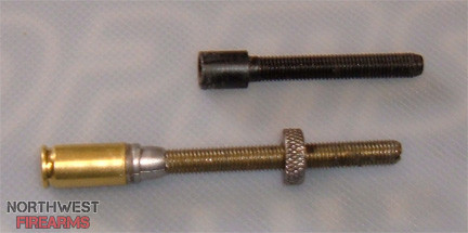

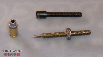

Try this Mike it's just a piece of threaded rod to match the die rod. Grind one end of it to fit the hole in your HP bullet and push them from the inside. That way you don't deform the bullet. :)
