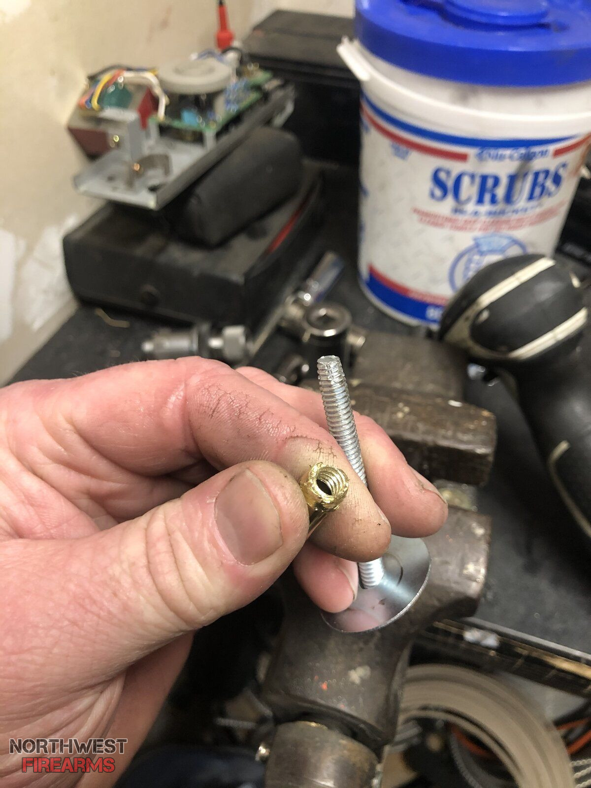

never in the years and 250k ish rounds have I ever had this happen. Twice in one night. 557454A0-D7E5-4F03-A3E8-644DBD5FD715.jpeg
For volume it can me problematic. Get it set right and you generally don't have problems. But I've had prob 9k threw that die and I think I messed it up pulling one of the stuck cases. Or it was some thing on the case. It's a slow process if you pay attention and are cautious. Which is a good thing. I've saved a few $$$$ on ammo and when the 300blk came out I was reloading for it and still do. At .17c a round and not $1.17 a round.

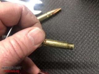

I bet he over bumped the shoulder on the brass when he sized them. That caused the case to be short. The 06 indexes on the shoulder. - distance between the back of the cartridge and the shoulder. If it's not correct you get light primer strikes. That will be the case on all rounds built just short of their index point. The belted mags don't have that prob bc they index off the belt. But all rifle rounds with a shoulder can have it happen if not sized correct.
I get them in my new conversion 300blk brass. Just a dent and no boom. Drop it in my Wilson case gauge and it's a couple thousand short on the shoulder.
