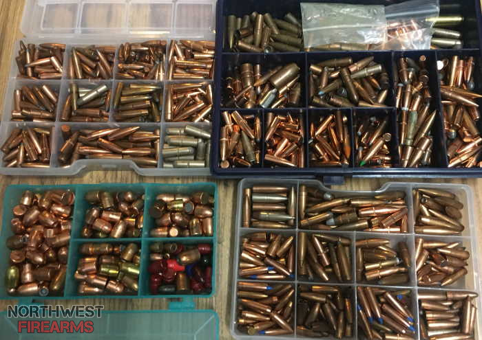

Just for kicks, here are some of my salvaged bullets, minus the huge quantity of 9mm, and all the lead that got melted down.
Sometimes I don't know why I save stuff like this. Even though I tinker with reloading a lot, I rarely have need to use random bullets. I know, I know; why do I save stuff like this...
