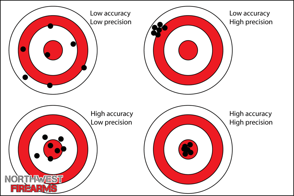

Do you understand why groups are often not centered on the bullseye?
Is that a lame excuse for trying to call someone out, or do you just need some education on how to shoot?;) For the most part, when shooting in competition you want to hit the X-ring. The more X's you hit, the higher your score. Is this making sense? You can shoot for 8's, I guess, if it makes you feel better....:D
Is that a lame excuse for trying to call someone out, or do you just need some education on how to shoot?;) For the most part, when shooting in competition you want to hit the X-ring. The more X's you hit, the higher your score. Is this making sense? You can shoot for 8's I guess if it makes you fell better....:D
Call it a lame excuse if you want. The reason a lot of groups aren't centered on the bullseye is because when you're working up a load, shooting for groups, you want as small of an aiming area as possible. As you start to shoot out the center of the target, your precision aiming point is no longer precision as it gets bigger and bigger the more holes you punch through it.
In competition, obviously you want to punch the X-ring as often as possible. Those targets generally have a more generous bullseye than say an 1/8" dot. When working up a load, or shooting for groups however, it is common practice to have the shots hit slightly away from your aiming point.

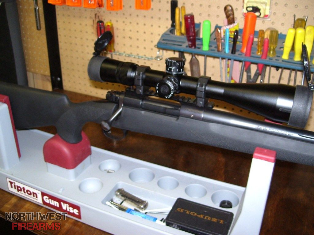

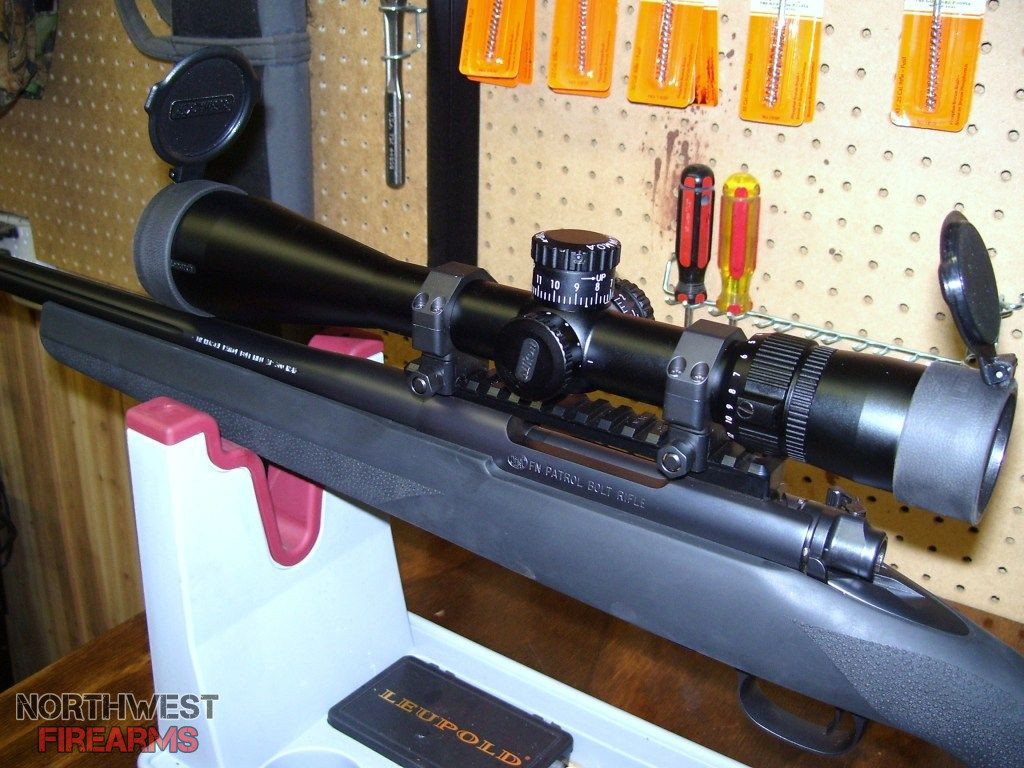

lambene, have you figured out what scope you are going to use on your new rifle?
one other thing you need to consider when you reload for your RPR s which magazine you are going to use. you are only going to get "So" much accuracy out of your RPR because it is magazine fed.
as for your scope choice don't do it, save up for a vortex or bushnell 3200 series at a minimum. buying a cheap scope is like shooting milsurp out of a precision rifle and wondering why you don't group well.
long range shooting isn't cheap nor does it have to break the bank. I have several 3k+ US Optics scopes and I also have a mix of leupold and vortex. there are better options out there than what you are looking at. scope base rings are not the place you want to go cheap at.
Do not judge me, I really like these scopes for the price.
<broken link removed>
I'm not going to judge my friend. If you have experience with that particular scope and know it works well, use it and be happy. If you don't have experience with that scope, then I might be like the other poster that said "don't do it". I'm not a scope snob and will use what I know works. Some may laugh, but one of my favorite scopes is a Nikon buckmasters 4.5-14x40 with side focus. It tracks very well and It holds zero. I've shot that one a lot out to 850 yards on both a 300wsm PBR XP and a model 70 7mm rem mag. When I was shooting centerfire competition, my scope of choice was another Nikon, but it was their top of the line Monarch X 4-16x50 secured in a good set of TPS rings. That scope was much better than my buddies vortex PST by a long shot. He agreed and sold it and swore off Vortex. He now uses a Schmidt and Bender 4-16x50 PMII:
I also agree with the poster that said you need good base and rings. However, the RPR comes with a 20 moa picatinny rail. I'd look for a good set of rings. Even the burris XTR 6 screw rings are great and affordable. The TPS rings are also good. You can go with high dollar rings, but you probably won't be gaining much over the TPS or XTR's. Back to scopes and what the previous poster said about the bushnell 3200 at a minimum. I agree, those are damn good scopes for the money as are the Burris FFII 3-9x40 with ballistic plex reticle. You can go fairly cheap on scope choice, as long as you know they have a good/great track record.
