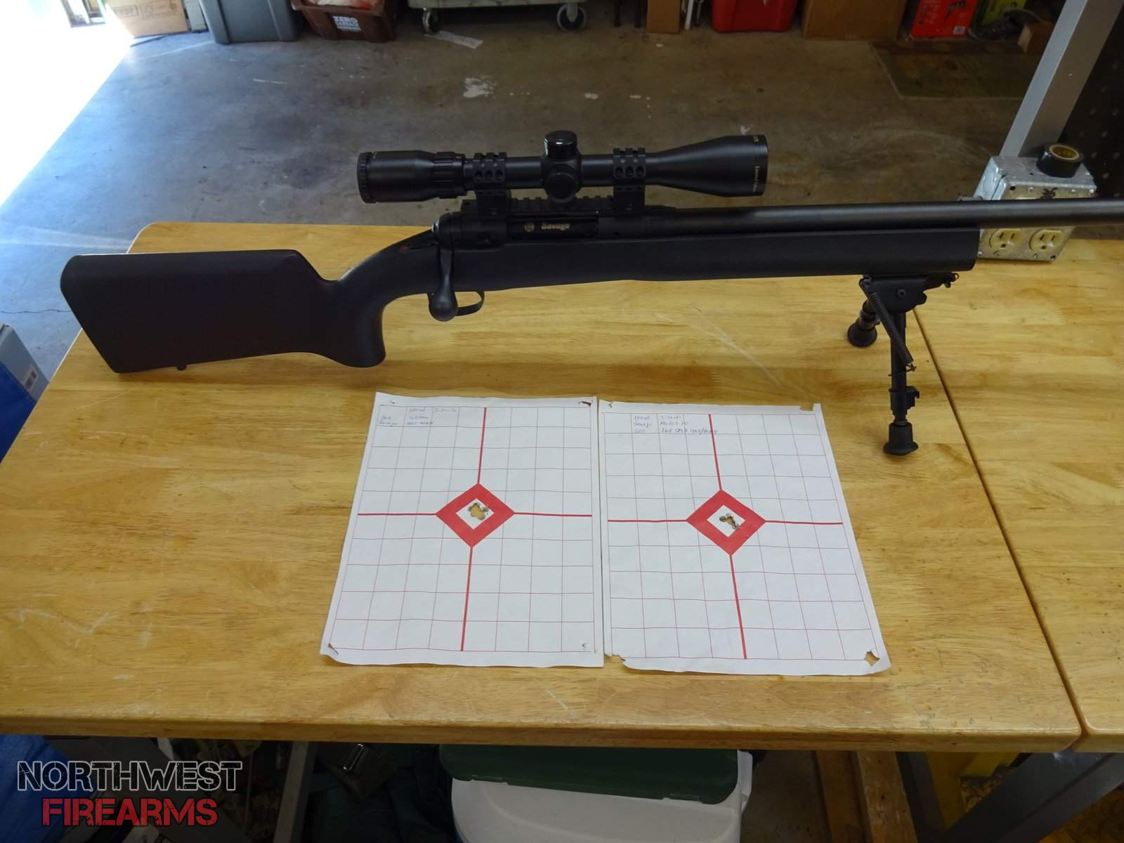

100 yard 5-shot groups with Savage model 10 and a cheap scope.
168 SMKs and IMR 4064

Awesome shooting Ron!! I like seeing those groups centered on the bull. The way it should be.....;)
