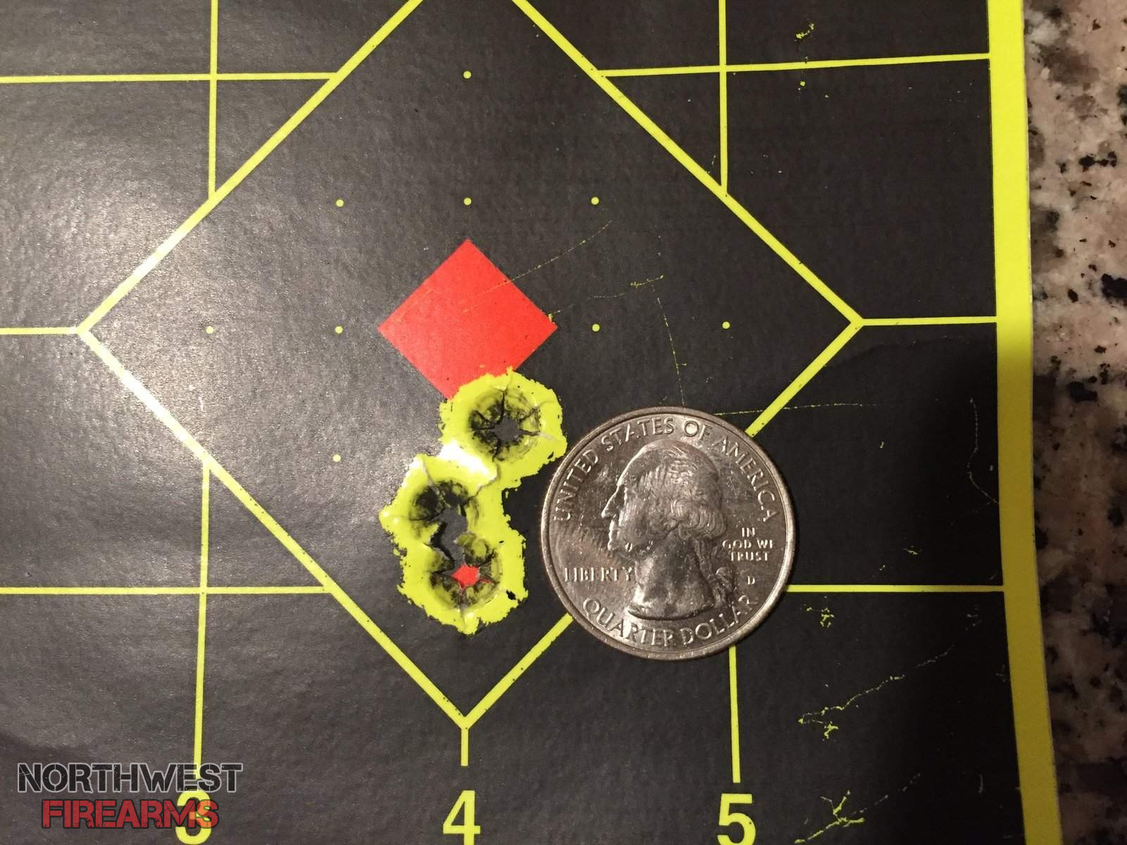

IMG_9583.JPG IMG_9460.JPG The target with a penny is 3rds of FGMM 175 @ 100yd @ the one with a quarter is Hornady match Palma 155 @100yd on the same day, so far mine really likes the heavy stuff, in a few days a package from MidwayUSA will be here and I will star load development for it, I know it'll be hard to improve on the factory FGMM but I'm going to give it my best shot lol
View attachment 346125 View attachment 346124 The target with a penny is 3rds of FGMM 175 @ 100yd @ the one with a quarter is Hornady match Palma 155 @100yd on the same day, so far mine really likes the heavy stuff, in a few days a package from MidwayUSA will be here and I will star load development for it, I know it'll be hard to improve on the factory FGMM but I'm going to give it my best shot lol
