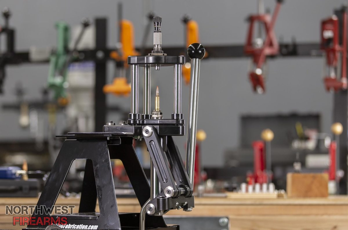

That Prazipress is sexy.
Very expensive, and rigid too. There's been a lot of debate on other forums on which is better, solid rigidity or a floating press. There are those who are complete fans of the Turban Prazipress or the Area 419 Zero. Mind you, I've never tried my hand at benchrest, F-class or PRS.

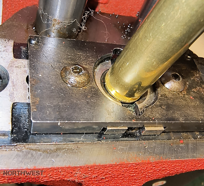

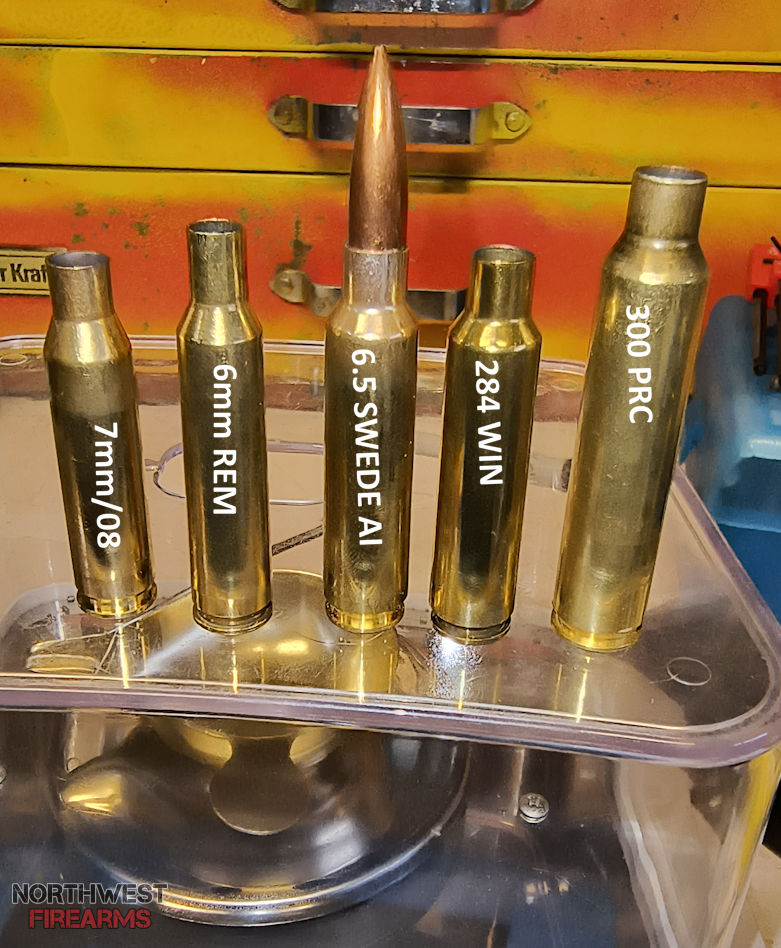

The simplest caution being, the large jaws don't naturally spread all the way to just drop a PRC case in. There is adjustment in the ram spreader pin from the bottom where you can spread the jaws wider, but it's still not all the way open as you would need it to be.

Photo examples from left to right:
  1. Cartridge comparison

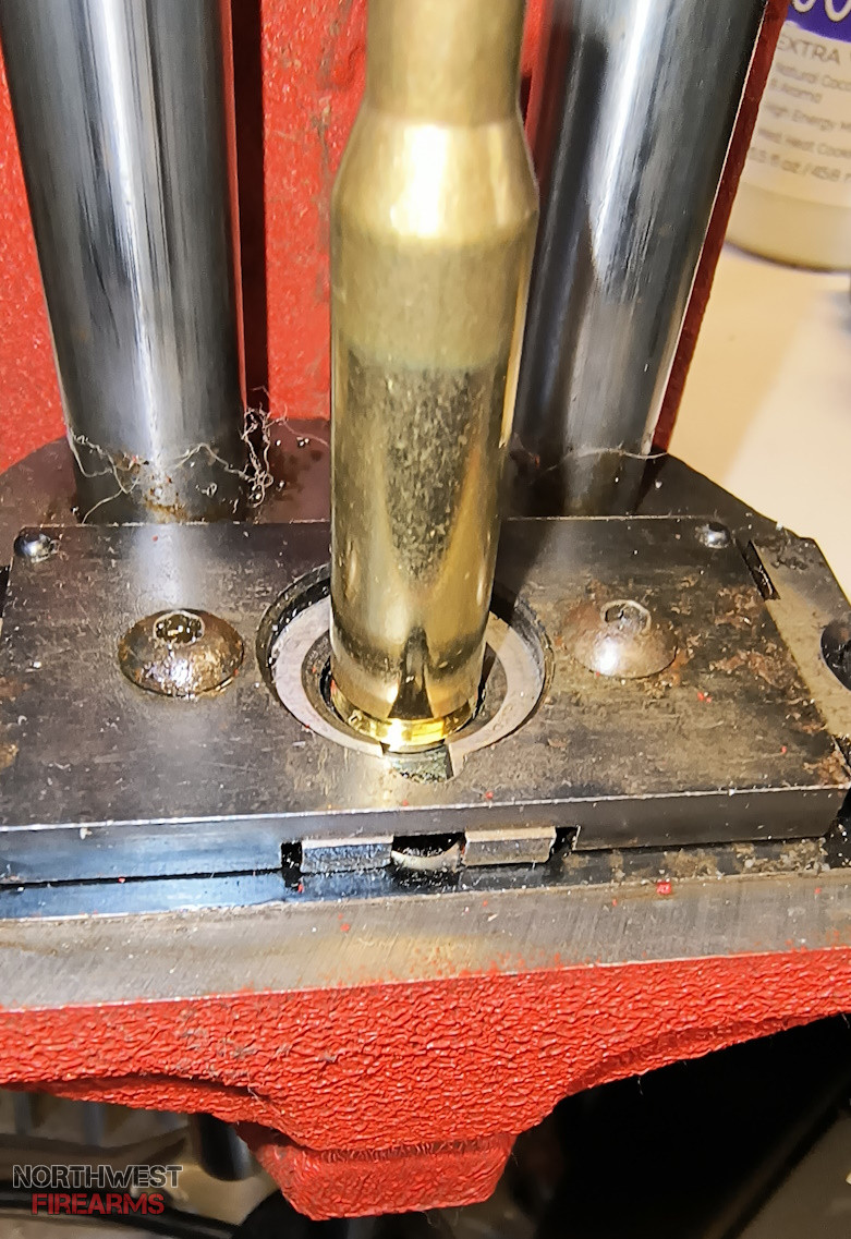

  2. How a 308 case fits in the Co-Ax so easily
  3. The 300PRC doesn't fit nicely. Notice it's riding on top of the jaws

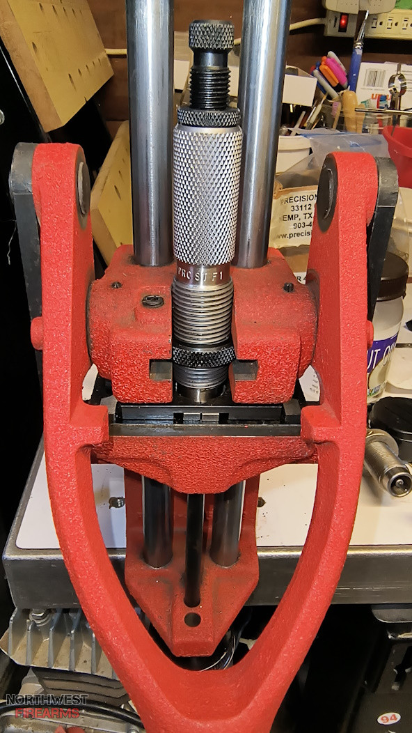

  4. Setting up dies is just like any other press. The Co-Ax does NOT cam-over

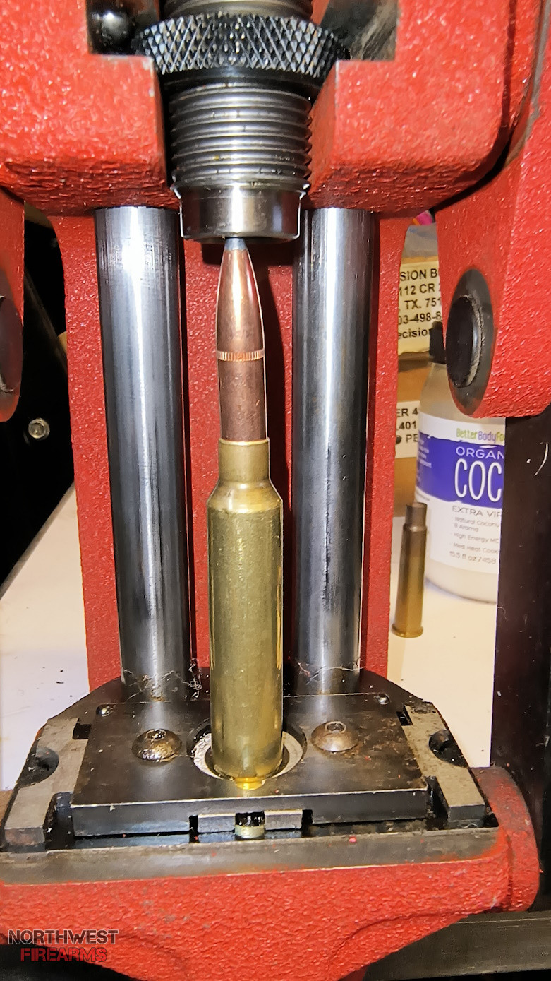

  5. Seating a 200gr bullet in the 300 PRC case, note the bullet is above the bottom of the seater die

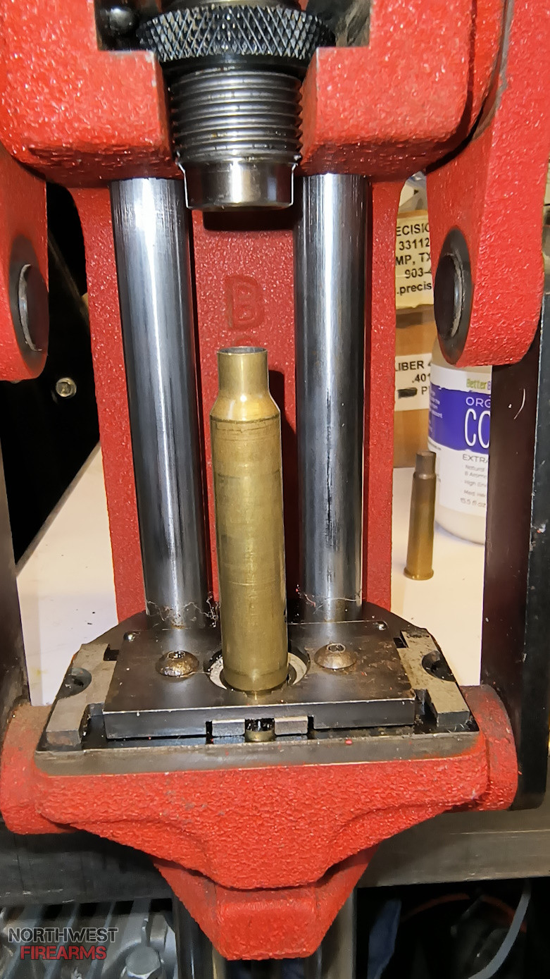

  6. Here is a 300 RUM/338 Edge case in the CoAx for comparision. I didn't bother showing it with a bullet

Setting up dies is just like any other press. The Co-Ax does NOT cam-over.
Cartridge comparison:
How a 308 case fits in the Co-Ax so easily:
The 300PRC doesn't fit nicely. Notice it's riding on top of the jaws:
Seating a 200gr bullet in the 300 PRC case, note the bullet is above the bottom of the seater die.
Here is a 300 RUM/338 Edge case in the CoAx for comparision. I didn't bother showing it with a bullet.

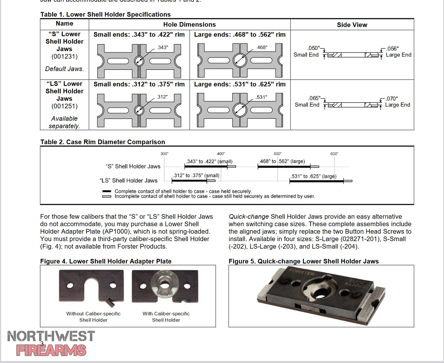

Here's an excerpt from their manual on different jaws to accommodate the larger cartridges:
Yeah, I recall the two ended jaws that ship with the press cover most calibers. I use the optional set which are extra small and extra large for 22 Hornet, 45/70, and 30-30 based cases IIRC.
See case comparability chart link on the page below.
