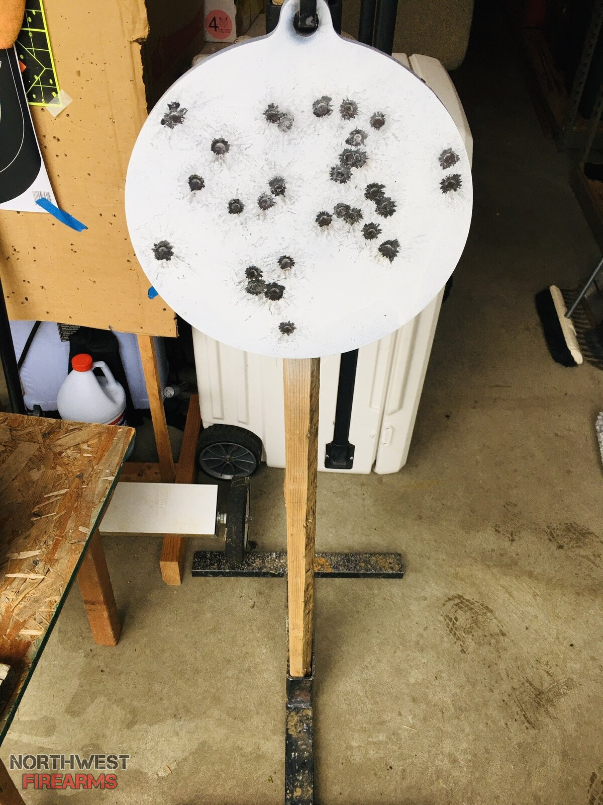

I too go for comfort/accuracy over velocity as most of my testing reveals minute of 9" steel target. ;)

It shoots fairly accurate for a 4 inch barrel out of a S&W 686 Plus. Talking 1-2 MOA at 15ish yards, double action, free handed. Thing is I want more velocity for more energy transfer, because ideally with this revolver of mine, it is a close in weapon system for dispatching a not yet dead critter and personal protection. Not a hunting pistol while it most certainly a capable and a capable round. It's not the primary purpose of why I bought this gun.

I mean when you put it like that, it does sound pretty dumb. To me it just feels like the velocity my reloads could be better when there are commercial loads that are spitting out carbine like velocities but they're coming out of a pistol. While the accuracy is lacking, I like to imagine both are obtainable.
