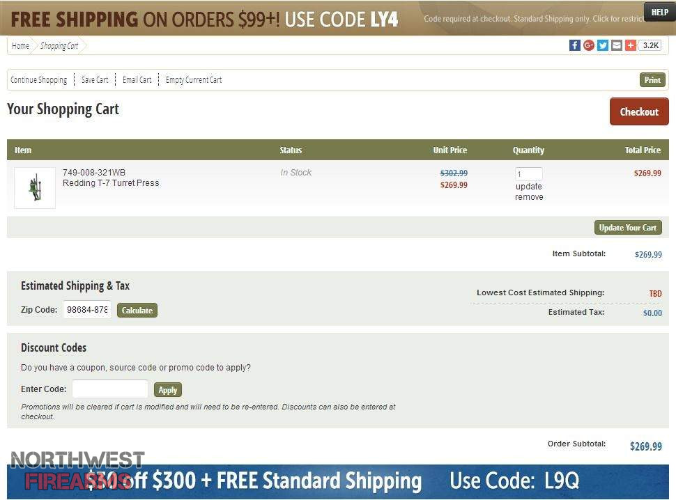

Here's a (very) nice turret and it's on sale @ Brownells...
I'd pass on that even if it was free.
All turret presses are single stage C presses.. you have to "batch load" and manually advance the dies/stations per operation..
unless it's a Lee auto advancing turret press (and it's an O press).. that costs one gubbin. anyway
Yep, a turret press falls between a single stage and a progressive.
More convenient that a single and not as fast as a progressive.
Redding T-7 seems to get the most positive reviews in the turret press category.
Built like a tank.
