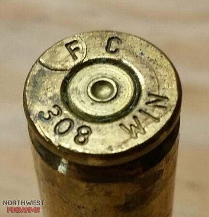

Here's a cratered primer with brass flowing to the ejector cut (note mark over the "F")....another sign of high pressure.
So @Josh89 this pic from @DirectDrive is really good. Sometimes you can get cratering like that from a loose firing pin hole, and it may or may not be due to overpressure. But the cut mark over the F on the headstamp and the bolt face marks make it pretty clear. That's the kind of stuff your looking for, though it's pretty rare to se that in pistol.
Not always. (On the primer) but always when the ejector is stamped but the stamped ejector can also be more a sign of excessive headspace than over pressure.
Remington 700's as of lately leave a crater because there is like .004" of slop around the firing pin and the hole in the bolt.

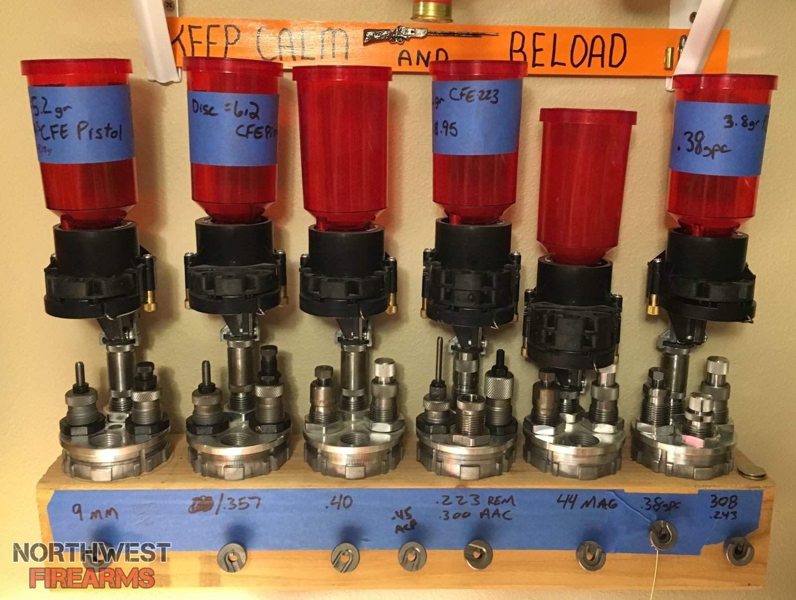

I just ordered this with 1 extra turret, 2 risers for the powder throwers & an extra powder thrower .
LEE PRECISION 4 HOLE TURRET PRESS DELUXE KIT | Brownells
True about the headspace, which is a whole nother problem. I think the point is that watching your brass is a good idea.
I have a savage Axis 22-250 that likes to crater with a sloppy firing pin with average pressures. But the primers start getting flatter and the bolt face marks let me know when I'm approaching max.
Now y'all have done it!!!!! Thanks a lot....:p

Not always. (On the primer) but always when the ejector is stamped but the stamped ejector can also be more a sign of excessive headspace. than over pressure.
Any unsupported area of the bolt face will yield high pressure clues, because as we know, brass "flows" every time it is hit with pressure and will find those areas.
The ejector cut and an oversize primer hole are unsupported areas of the bolt face.
So in summary, get to know your particular firearm and what "normal" spent brass looks like.
