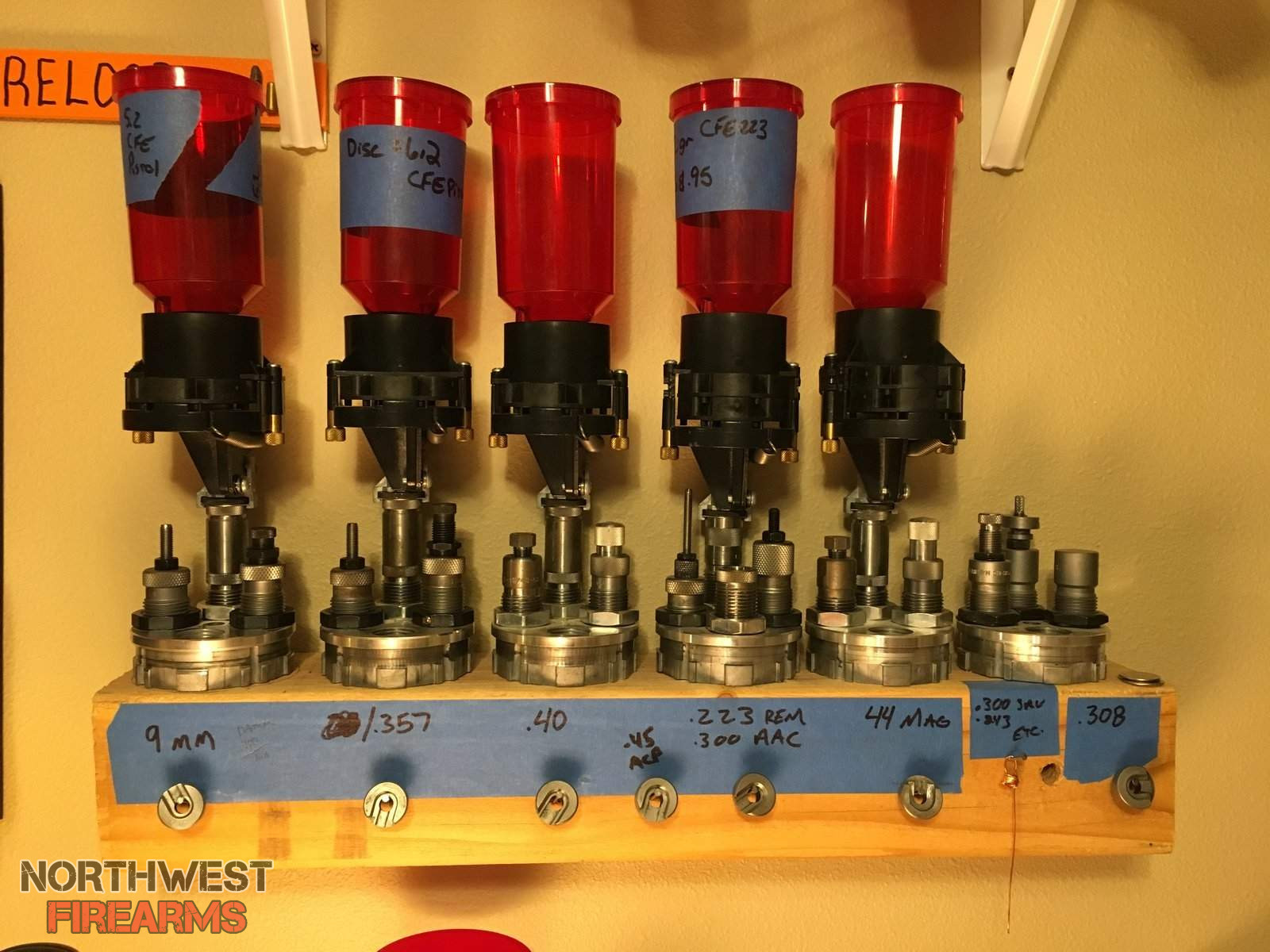

Oh and obviously dies for the calibers you use, and Everytime you buy a set of dies get a turret, a powder measure riser, and a round red storage box for the dies mounted in the turret.

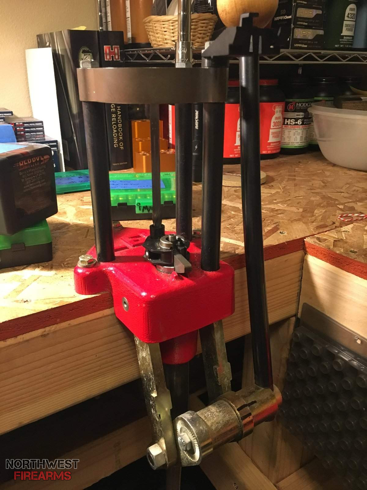

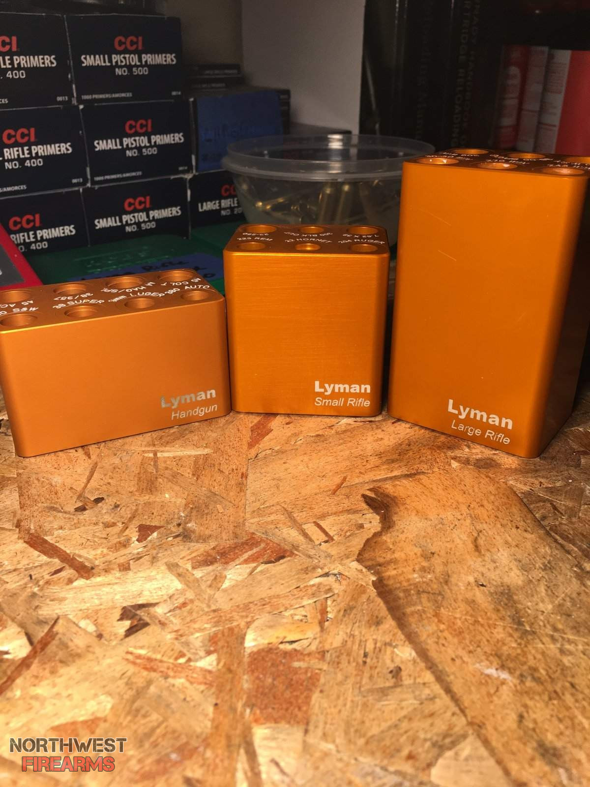

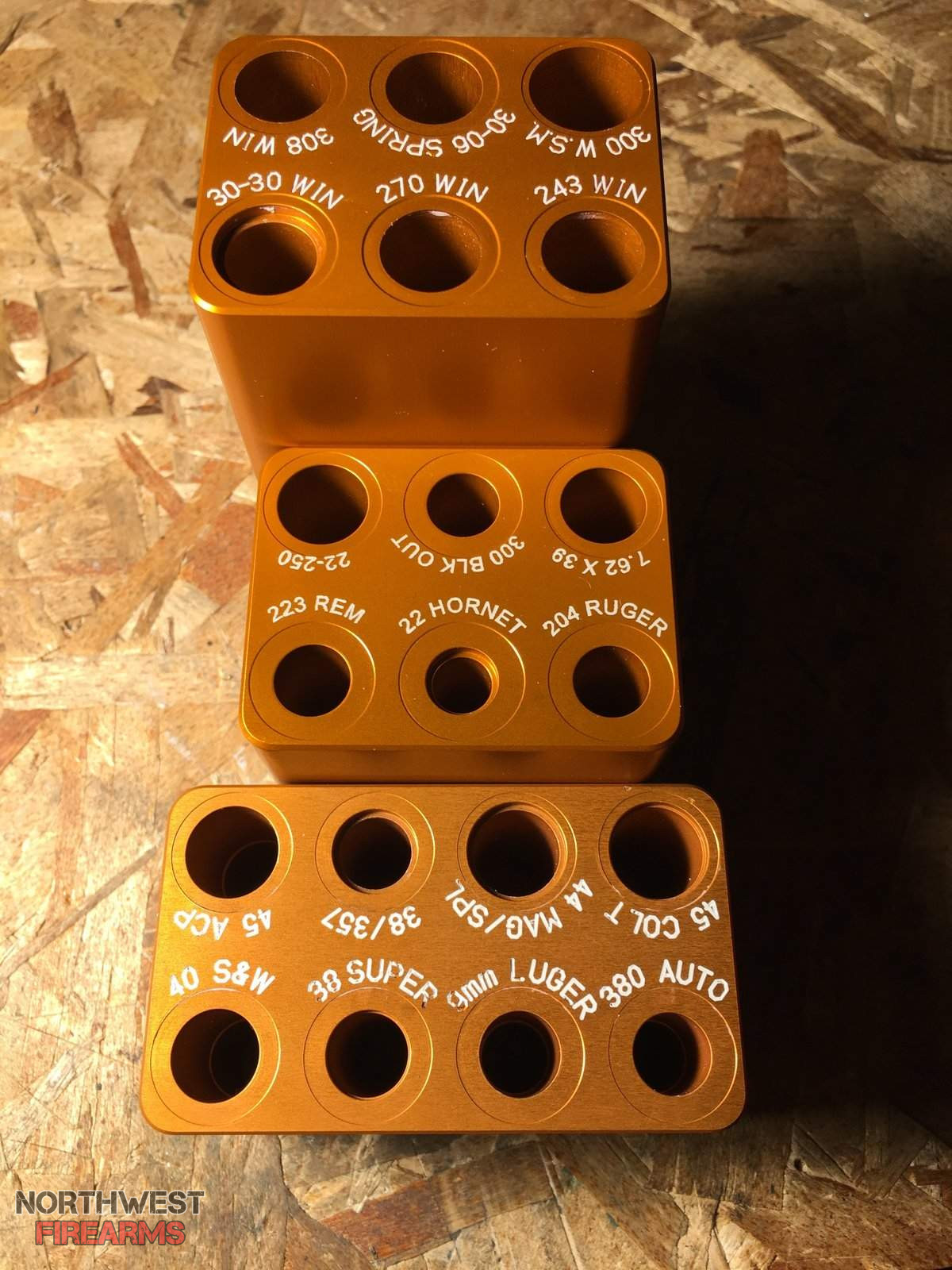

Case gauge:
Lyman makes really nice multi caliber case gauges.
