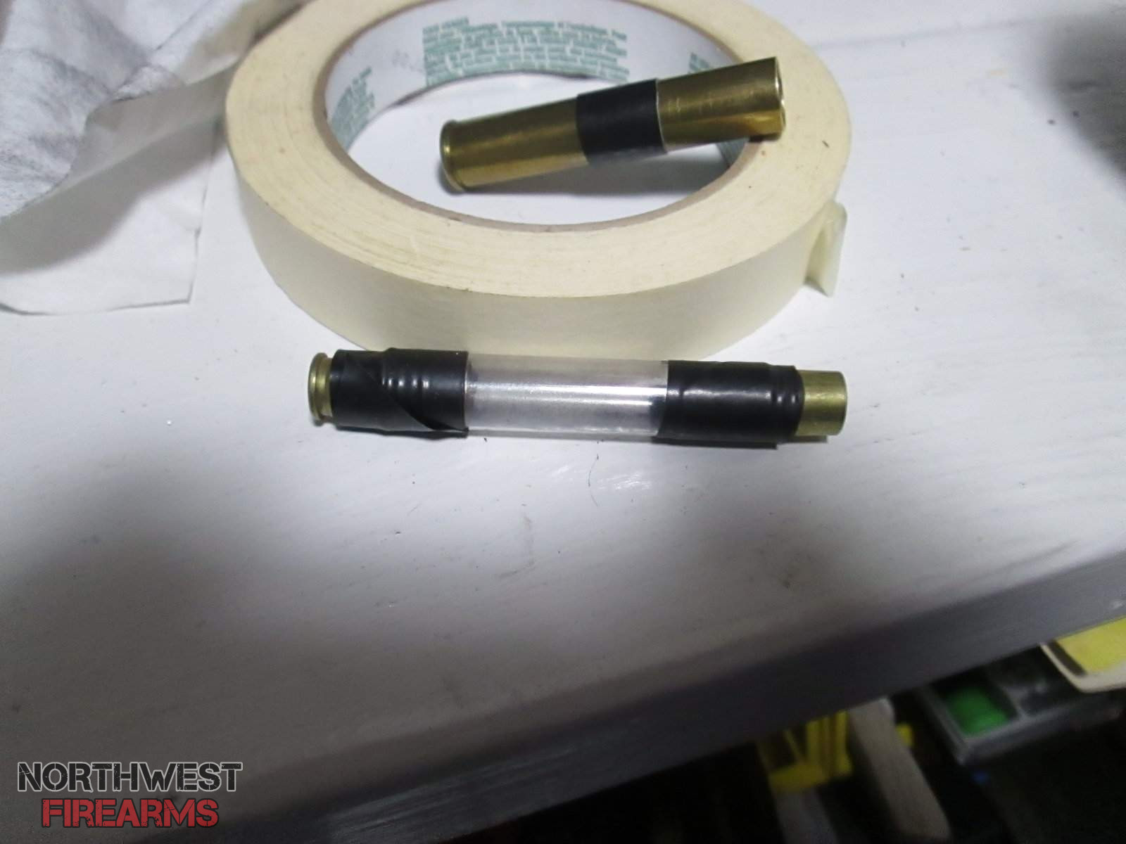

I like to thro 10 loads to weigh and then average when dealing with small amounts, even in an adjustable measure.
For 9mm and 45ACP, I made a Long case that'll hold 10 charges, and fit between the shell plate and exp/powder drop die:
So if I'm looking for 4.3 grains, I'll thro 10 loads into that case and set my scale for 43 grains (4.3x10).
Weigh it and adjust the measure accordingly.
I find this "weigh" easier than chasing/adjusting for a 0.1 grain, measuring a single thro.
