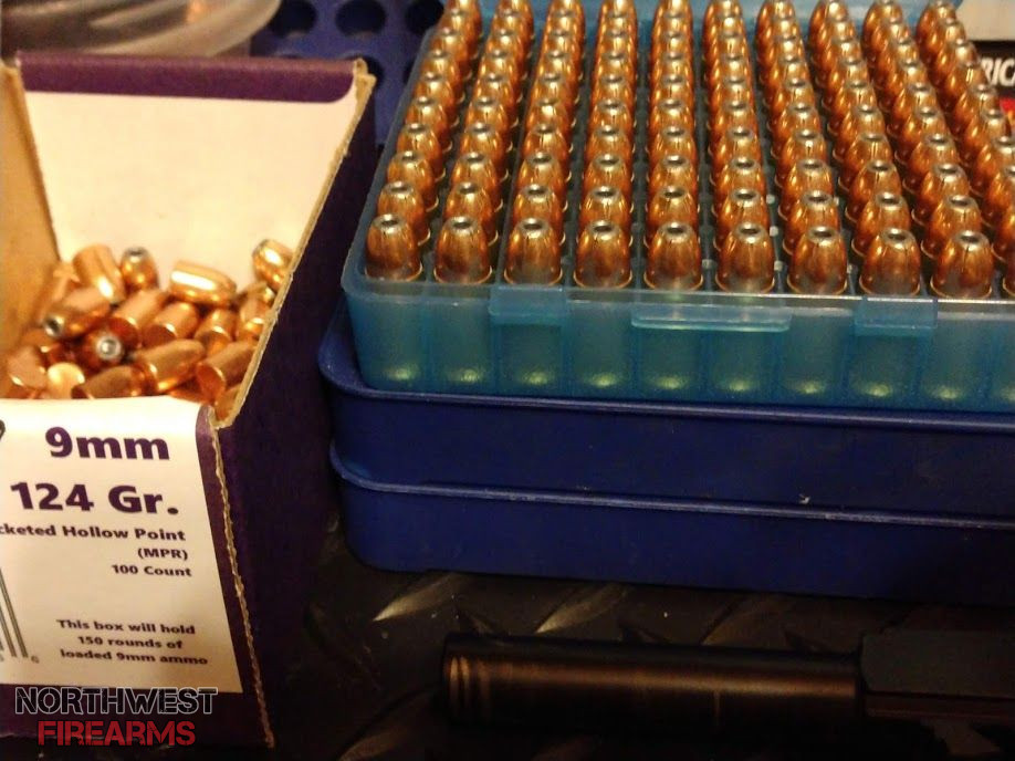

Did another 100 rounds of 9mm using RMR 124gr MPR hollow points, 5.5gr of Ramshot Silhouette loaded to 1.100 will just barely plunk in my Glock Gen 5 G19. Should be good for 1100fps.
I hate reloading for 9mm. Using a single-stage press, it takes me 2.5 hours using fresh cases to make 100 rounds. I miss the days of going to Walmart and picking up 100 rounds of Federal Brass ammo for $25.
Cranking out 100 rounds of 10mm takes the same amount of time but is infinitely more satisfying.
Yikes! In that time, I can generally load about 1000 rounds of 9mm on the LnL progressive. Including coffee breaks. Still sounds like a good load for accuracy you have there, and much better than nought.
I don't shoot really high volumes of anything really so every time I considered a progressive setup I couldn't really justify it. However I have settled on a turret press for my slightly higher volume ammo. I think I can approach 400 rds an hour with 9mm. I have 3 spare turret heads with two chamberings per head all setup ready to go so change over is quick jesus bolt removal and tightening affair. May be an option to consider for others with in between consumption like me.
