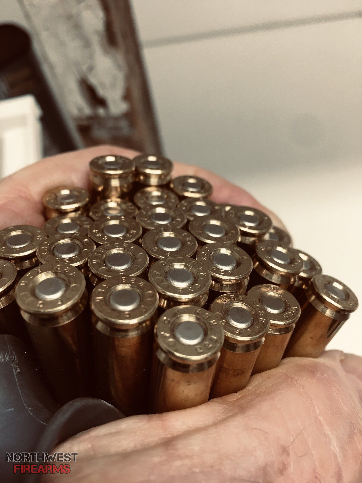

I too am in the swage camp. Here are some of the cases I've acquired from my pit, they were cut too deep so when I find these they go into the recycle bucket. I'm not chancing anything in the PP area.

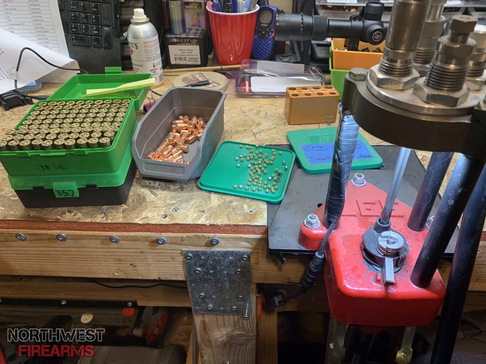

Making some fodder for the Henry tomorrow.
.38 Especial y .357 Magnum

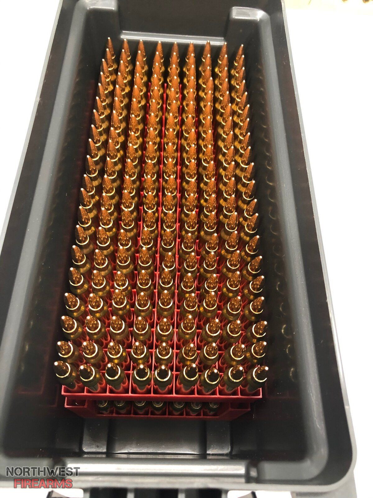

I 3d printed some ammo can bullet holders,
i designed them to fit the harbor freight ammo can,
holds 180 rounds per layer, fits 2 layers, 360 rounds total.
and i loaded 400 rounds of 300 BLK, and 560 rounds 223
