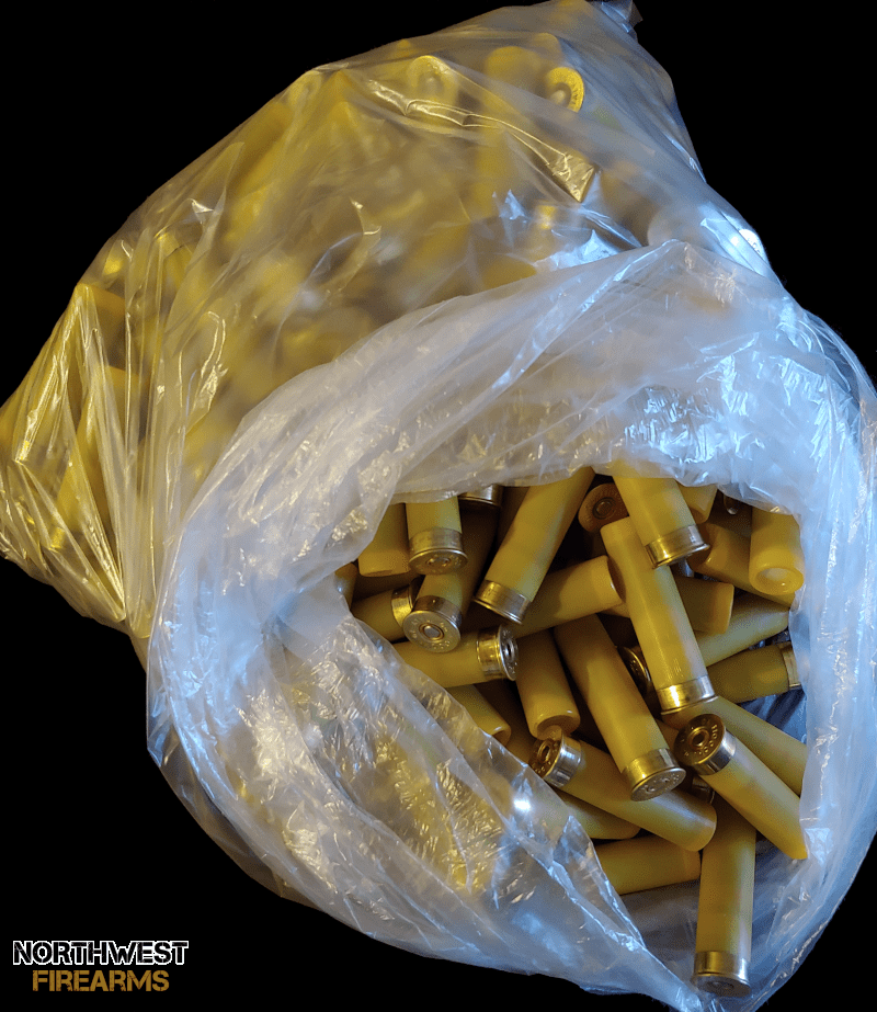

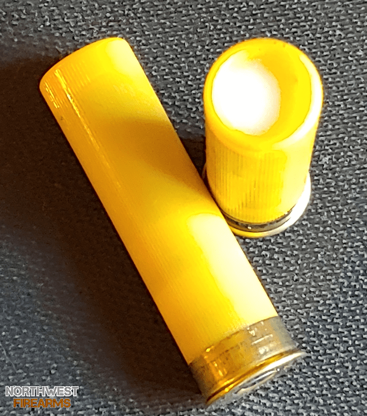

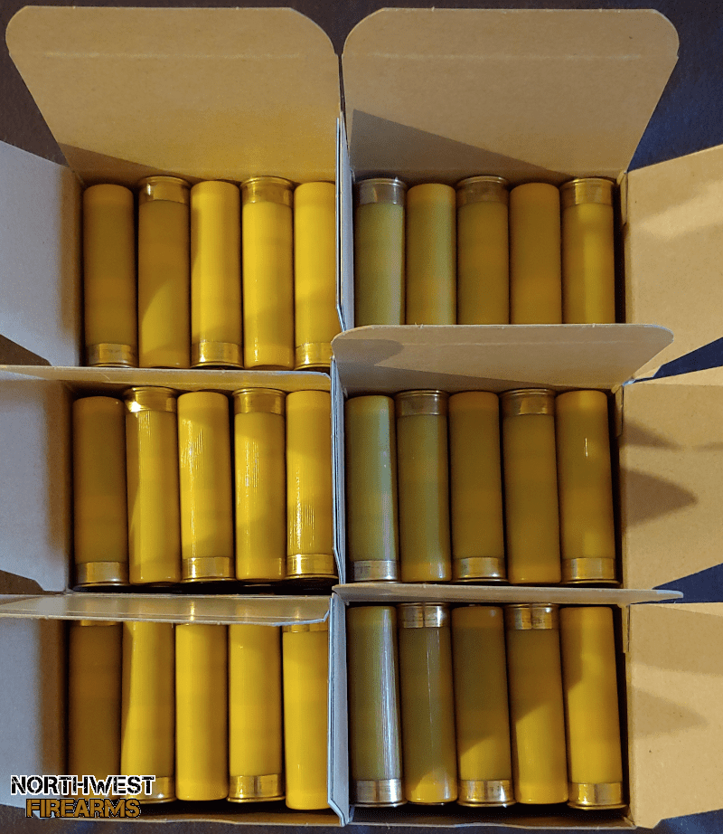

Finished up last night before bed, 150 plinker 20 gauge #4 buck shotshells.

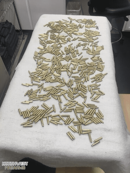

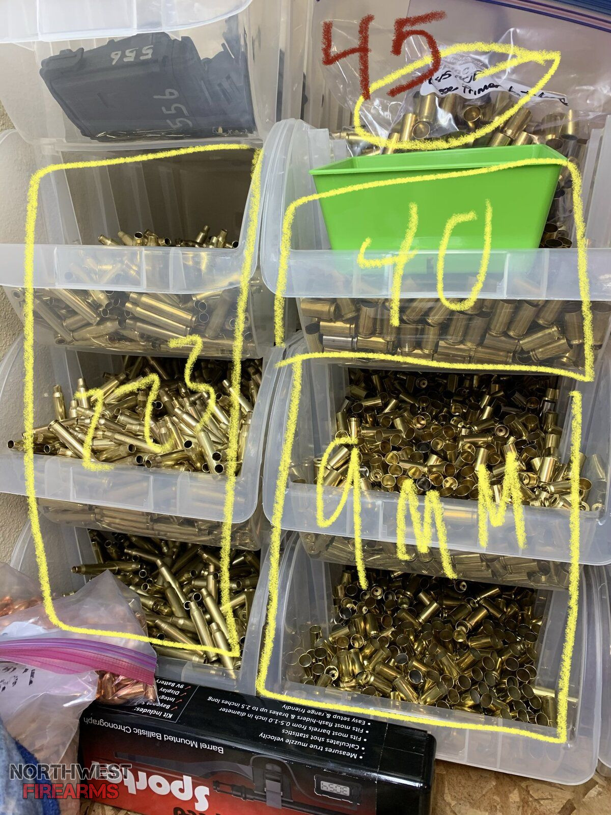

I've recently finished prepping all of my 'raw' brass in house. I spent about 5 hours trimming, 3 hours swaging, 3 hours sizing and two hours washing/drying about 1,000 pieces of .223/5.56 brass.
I'm now set for life in my bolt rifles. Perfect brass ready to go. Assuming I never reuse them after shooting this point forward.
I've finally caught up. What a relief.
