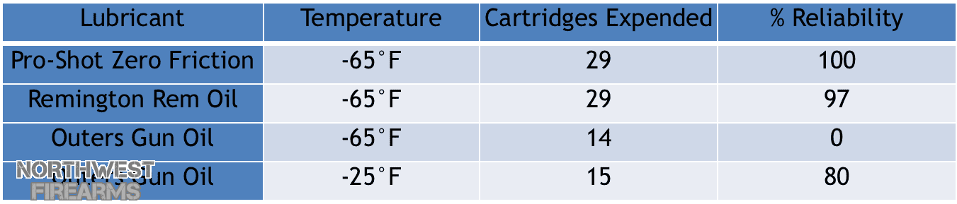

This has nothing to do with the 1911 having larger rail surfaces than modern designs. The gun has performed up to 100% reliability down to -65 deg F with common every day lubricants.
I seriously doubt 25* (thats positive 25*) and some little wet moisture from melted snow, rain or whatever while reloading is the problem.

Great video. Looks like Break Free didn't do so well, but I've had no issues with it at the temps that I experience. Then again, I use the same guidelines Bob Hope used for golf. He used to say "I like to play in the low 70's. If it gets any hotter than that I'll stay in the bar!"
I was actually surprised Rem Oil did so well I always thought it got bad reviews. Ive never used it.
We might get down to the teens round here, worst case... maybe a bit lower in Eastern Oregon, but no where near -65. At least I know what oil to use in case though, lol.

That was a great video.
Pretty much slapped me up side the head though...
Breakfree is typically my go to oil, and while I have a can of rem oil I grabbed once when I couldn't find anything else and needed something quick, I call it my expendable can and use it more for cleaning than lubricating...
