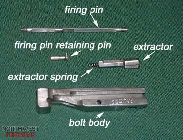

If you're comfortable with this level of disassembly. Clean the firing pin channel and examine all associated parts for wear or damage. Be careful about reassembly, as a firing pin protruding and stuck can cause slamfiring. A runaway sks is no fun.
