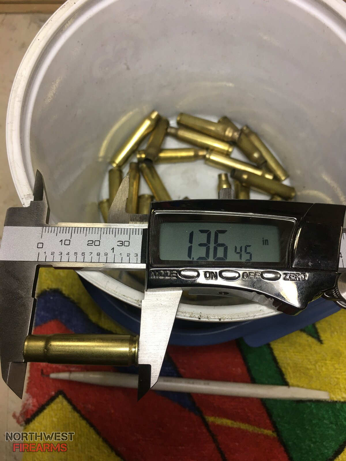

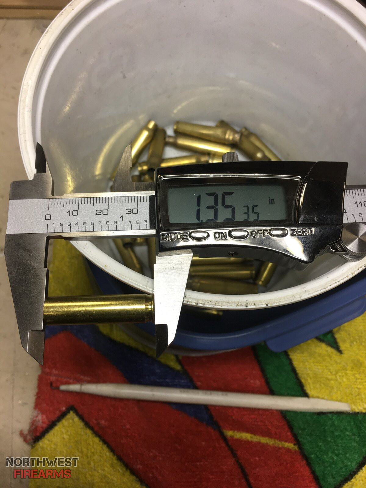

Nice! IIRC you made your brass from 5.56. What did you find to be the easiest way to cut it down to 300 BO?
A harbor freight chop saw, With a cut off jig and a vacuum attachment.
I cut them at the preferred length (1.35+/-) the resizing stretches it just a bit and not so much left to trim off.

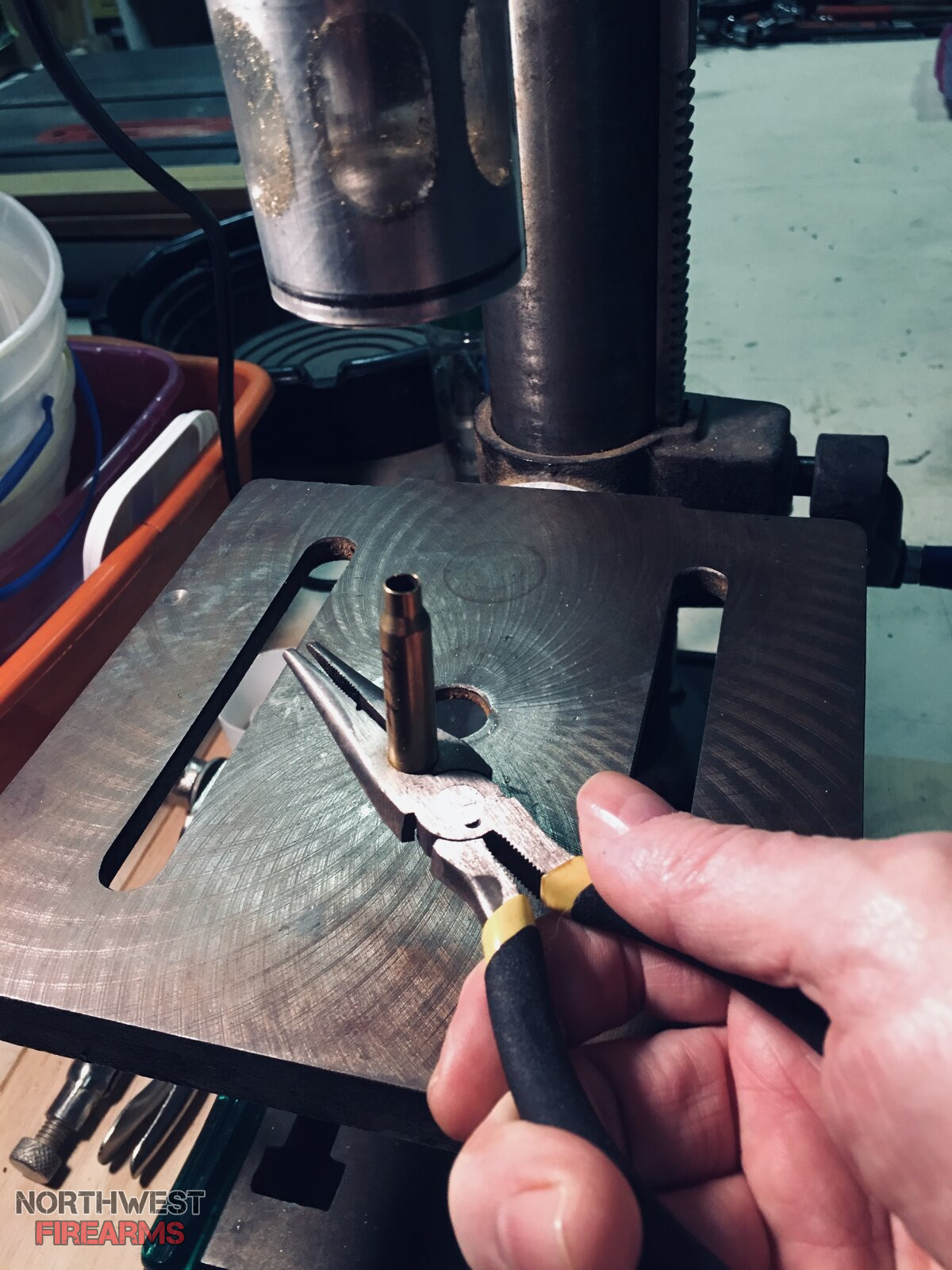

Oh yeah, one more thing about cutting down your own brass. Trimming it the first time sucks. I have the frankford arsenal case prep station and I was having issues getting uniform case lengths. So, I decided to try a lil crow case trimmer. Nothing fancy about it, but it works like a charm every time. Use some grippy gloves to hold the base of the shell. It will save your fingers a ton of fatigue in the long run.
Here's a tip if one has weakened hands like I do.
A simple pair of needle nose pliers is perfect for the task.
