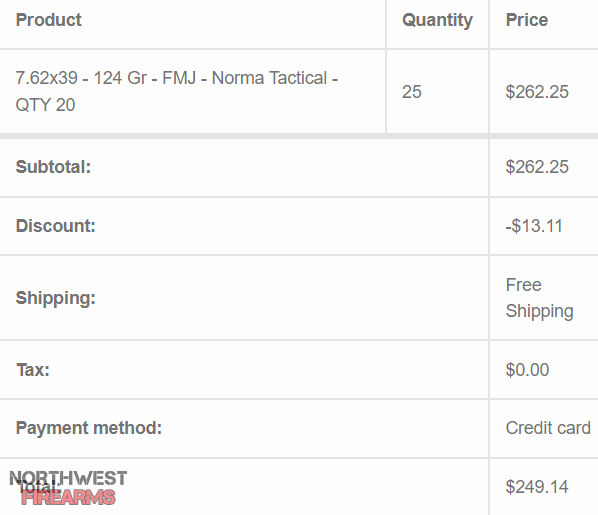

I've kind of been watching since I became aware of them recently. I've noticed they run sales rather frequent. That's why I only went for half a case. They gave me a one time first time buyer discount... so wanted to take advantage.. ending up with more than I need in the short term, but who knows which direction prices are heading in the immediate future and don't currently own a single round of 7.62.
