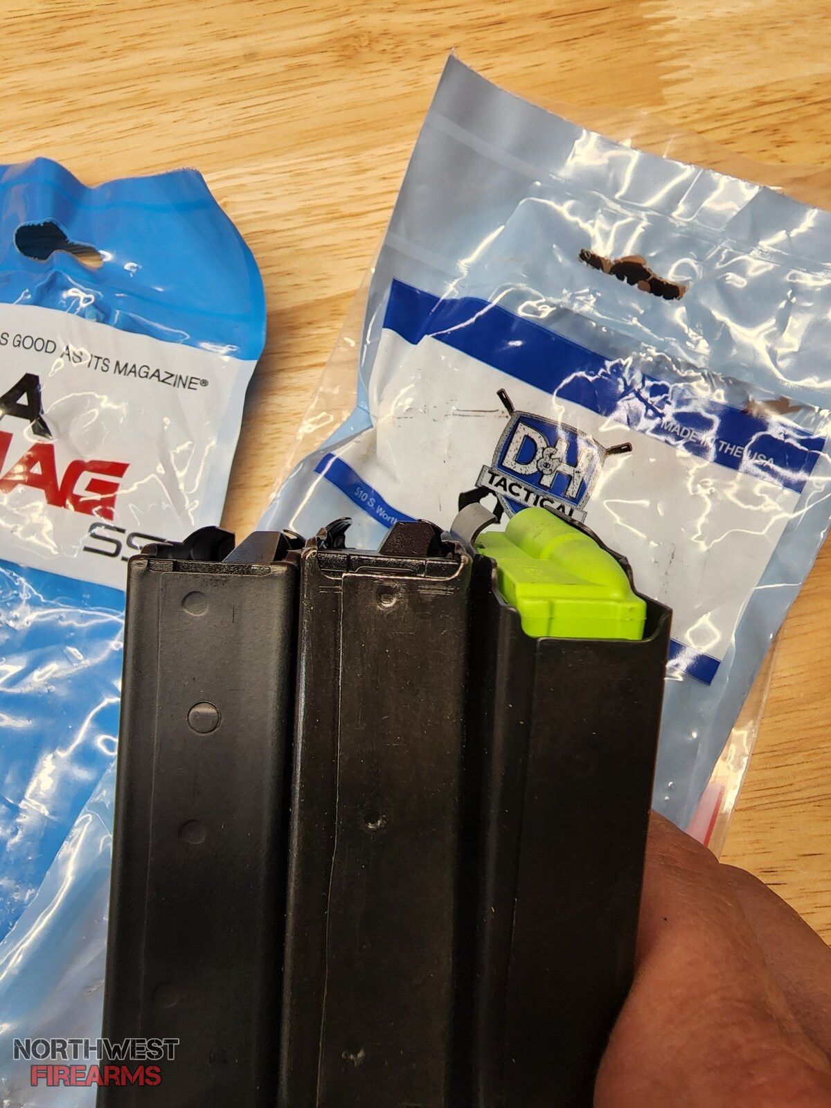

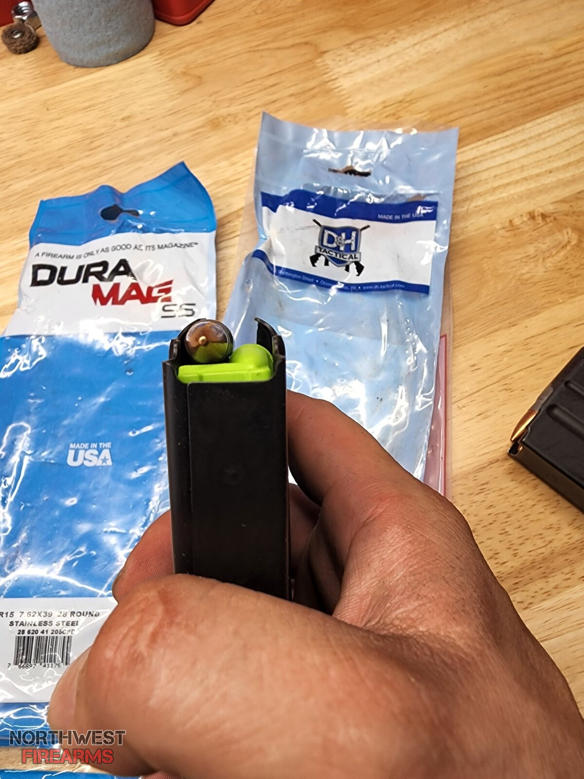

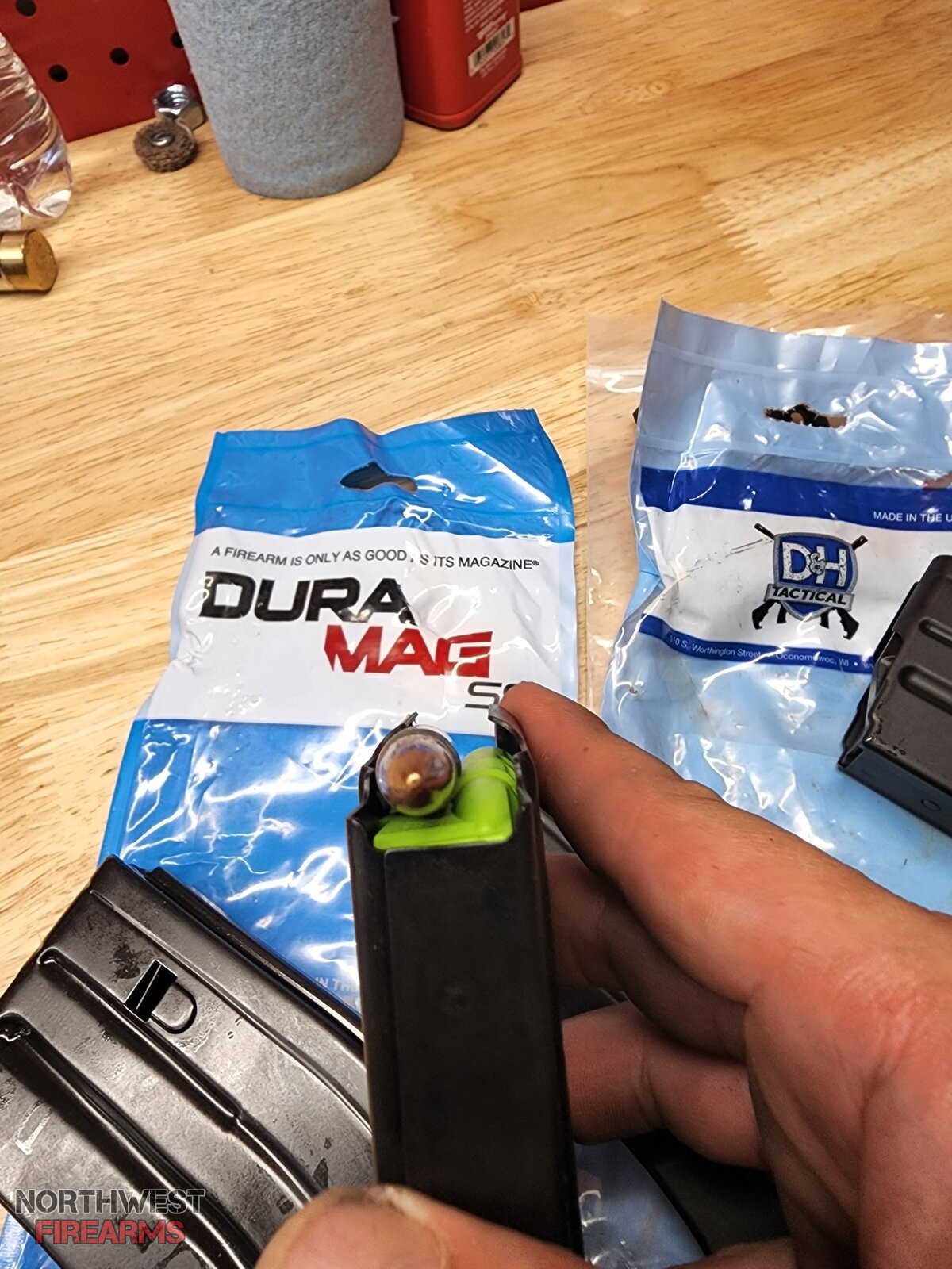

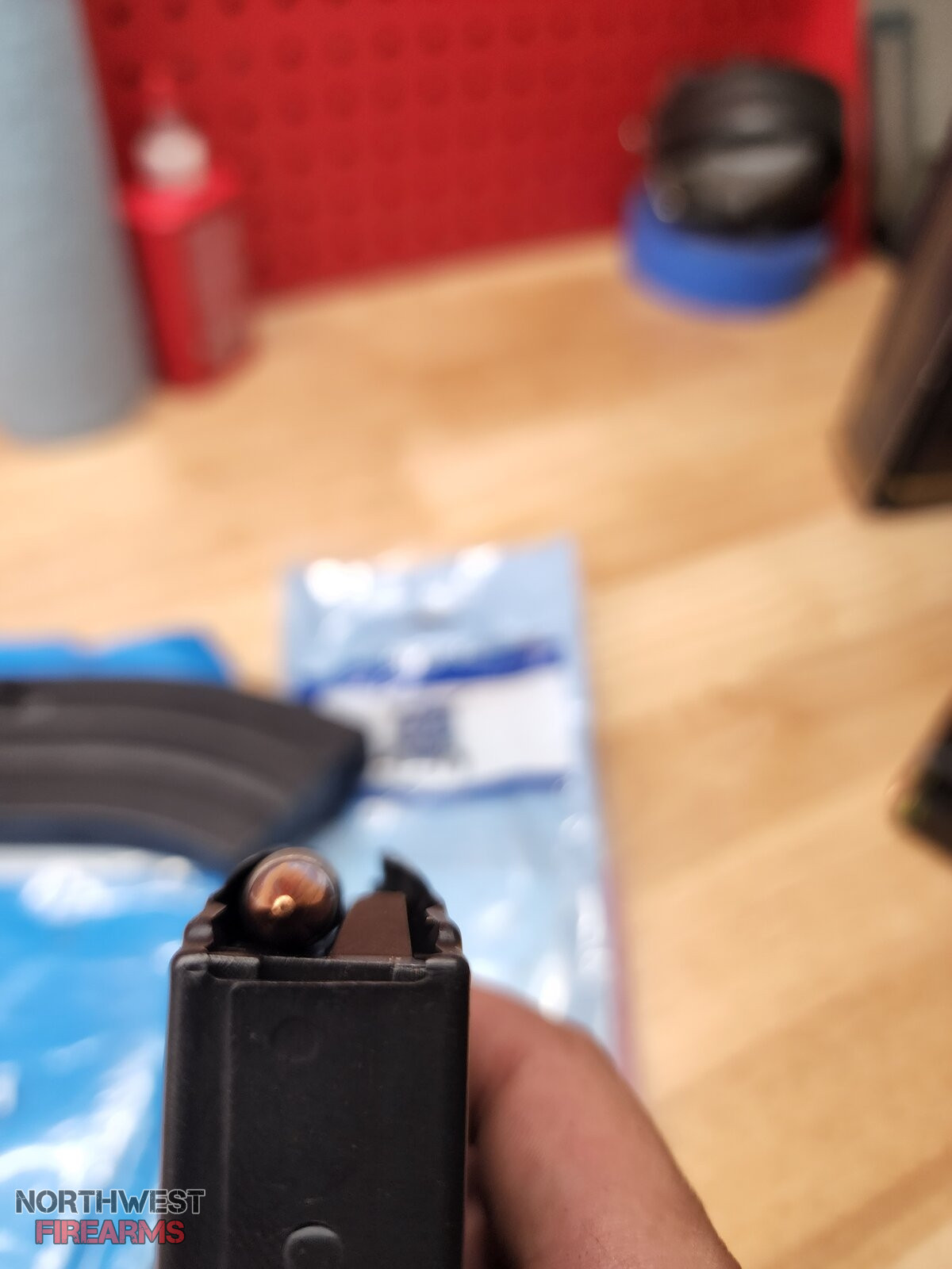

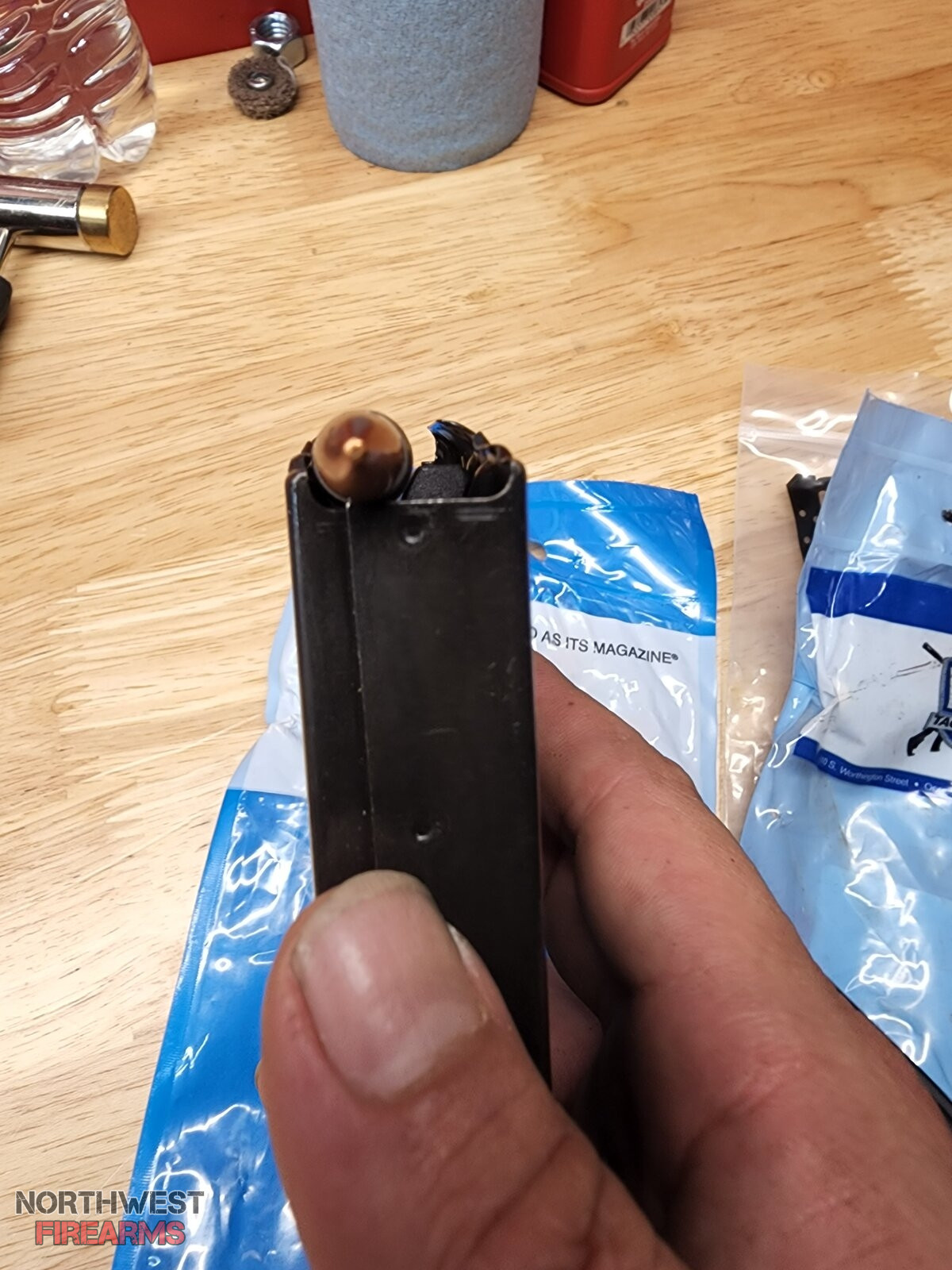

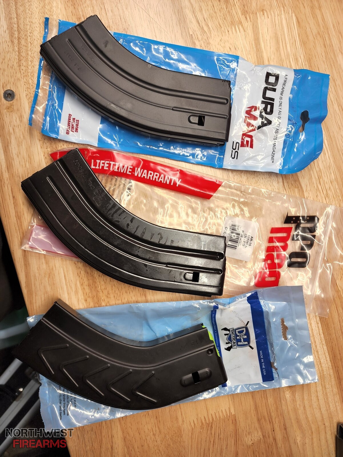

I have about quite a few 7.62x39 mags all different brands. D&H seem to be the best bullets don't catch lip and follower seems to be a lot better design. C-products, ACS, dura-mag and pro mag seems like you have to grind and polish the mag lip. The case of the bullet will catch the mag once it exits, this is why people say not to run all 30 rounds as the last ones get enough assist from the spring. All brands of mags work pretty flawless if you grind and polish the lips down. Make sure the round can push forward and not touch the front of mag. I have also polished all surfaces on the top of the mag as steel on steel tends to stick.
20220821_171943.jpg 20220821_171909.jpg 20220821_171838.jpg 20220821_171756.jpg 20220821_171728.jpg 20220821_171952.jpg
