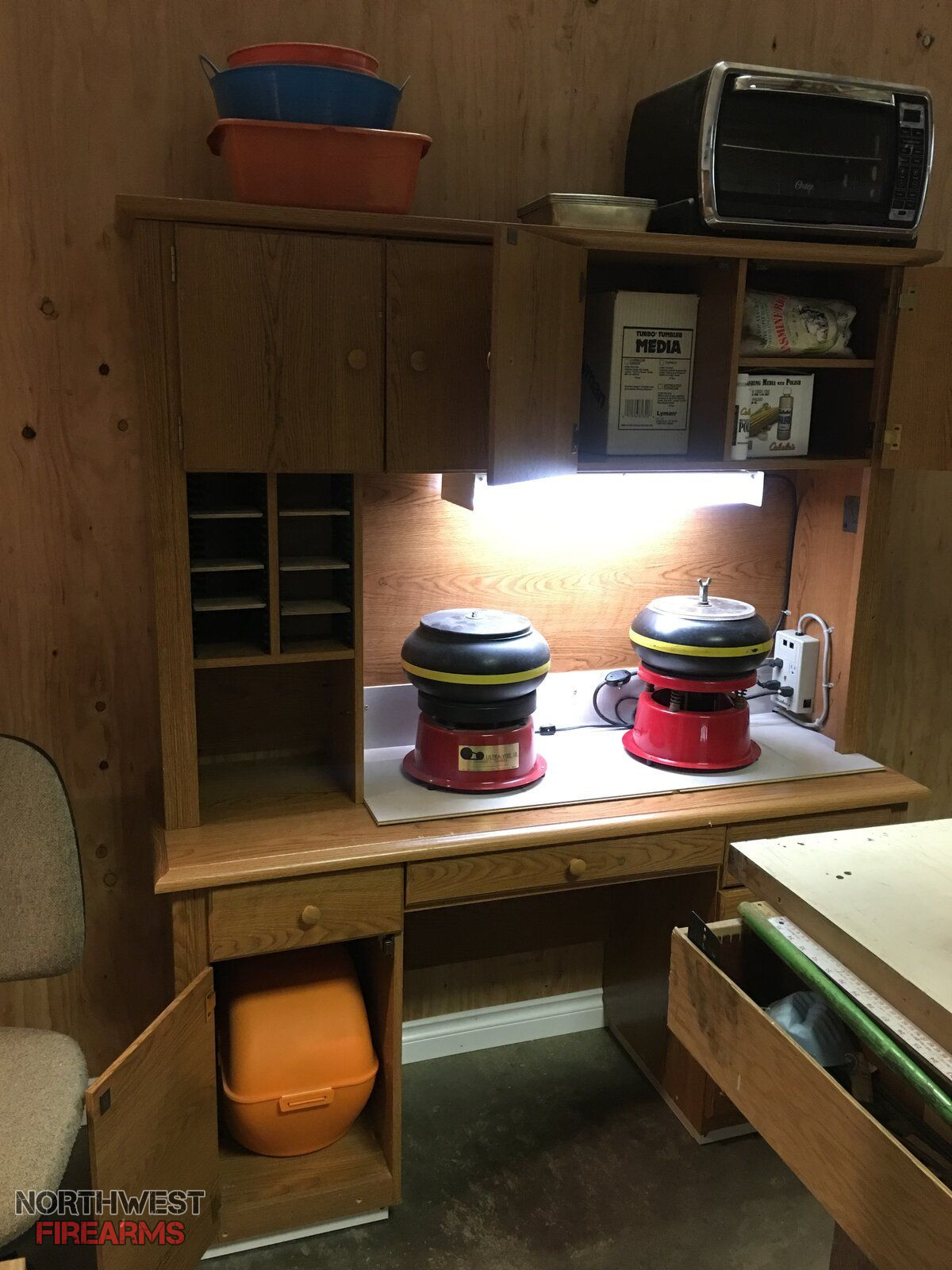

Here is my cleaning station I just put together. My twin Thumlers now have a home.:):s0033:
