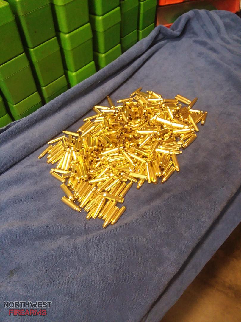

I have found that by carefully pouring off most of the water I can use the magnet to pull the pins at the bottom out. Once I spread out the brass I then run the magnet slowly over the brass The magnet is strong enough to pick up a piece of brass with a pin inside. Last 3 times I have had maybe 2 get picked up. And yes I also deprime before I clean. Gets the pockets clean.

A couple of weeks ago i was cleaning a three gallon bucket of 9mm and a five gallon bucket of 223/5.56 range brass.
When i wet tumble i drain the scum water off out of the drum into a small bucket. I hold my hand so all of the pins and brass stays in the drum.
I will pour clean tap in the drum & shake it up a little by hand and drain it again.
Then add more clean water water & tumble it again for about ten aditional minutes.
The water will have more dark crud from this procedure. I will drain this off then pour the cases into the small bucket & add clean water. I grab some cases & hold them in my left hand, grab two cases & hold them with the primer pocket pointed up & swish them in the clean water so any SS PINS come off the cases and drop in the water.
I will then place the cases on my drying racks. Once they are all on the drying racks i put another round of cases in to tumble.
I will then hit the cases with the airhose and let air dry if it is warm outside and really sunny so the brass will completly dry. If not warm & sunny I will heat the oven up to 190 and put the brass in for twenty minutes & shut the oven off and let the racks with the brass on stay in there until they cool down.
On one batch i didn't put the pins back in the drum that I dumped out with the brass, there were a few pins in the drum that stuck to the drum when I dumped the brass, but not many. That batch of really dirty range brass did come out really nice looking.
