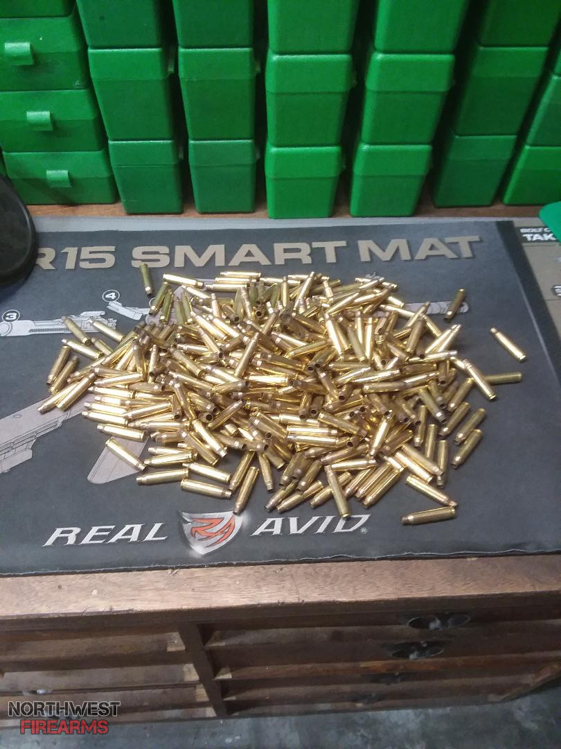

I never let my brass get dirty enough that I need to tumble it first. Just isn't going to happen. I don't even pick up range brass, unless it's somewhat clean. Here's about 800 pieces of .223rem that I picked up the other day:
Here's some 6.5 creed I shot over a weekend. This is after being fired:
Absolutely NO need to tumble that and get that damn media all in your dies and all over your bench. No need...
