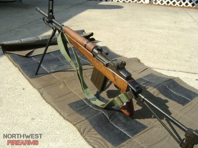

I had Shuffs build this one years ago before they were popular , before parts were cheap and easy to find. Took me awhile to gather them all for the build
