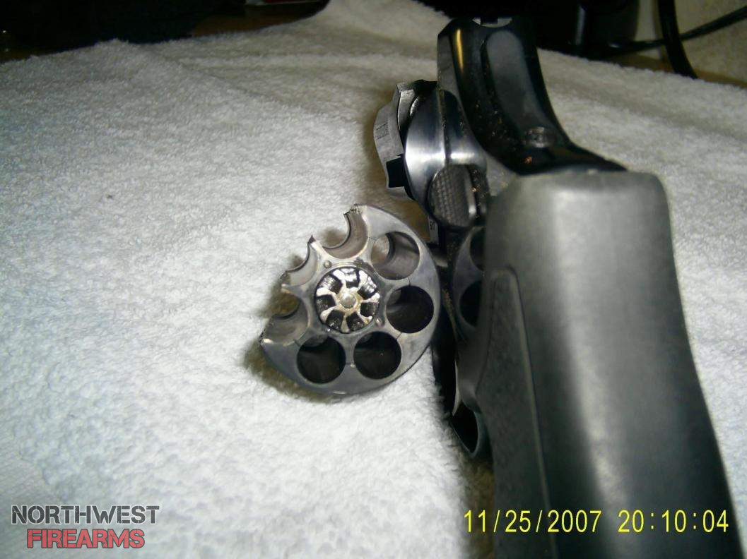

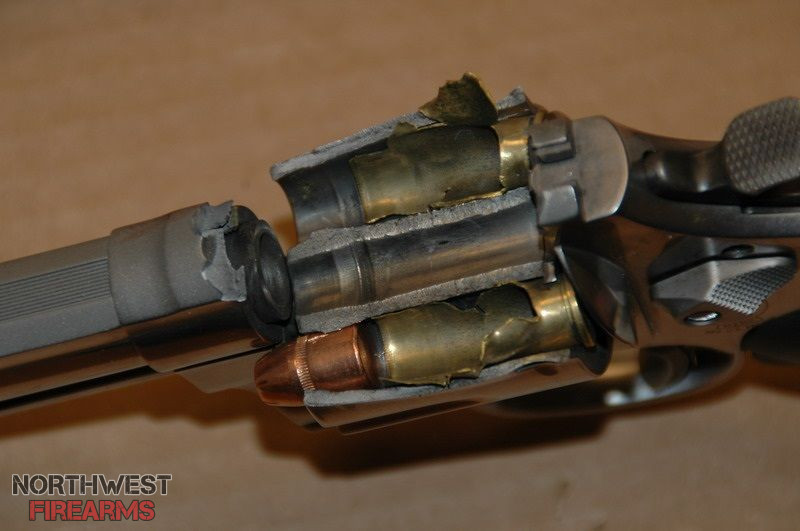

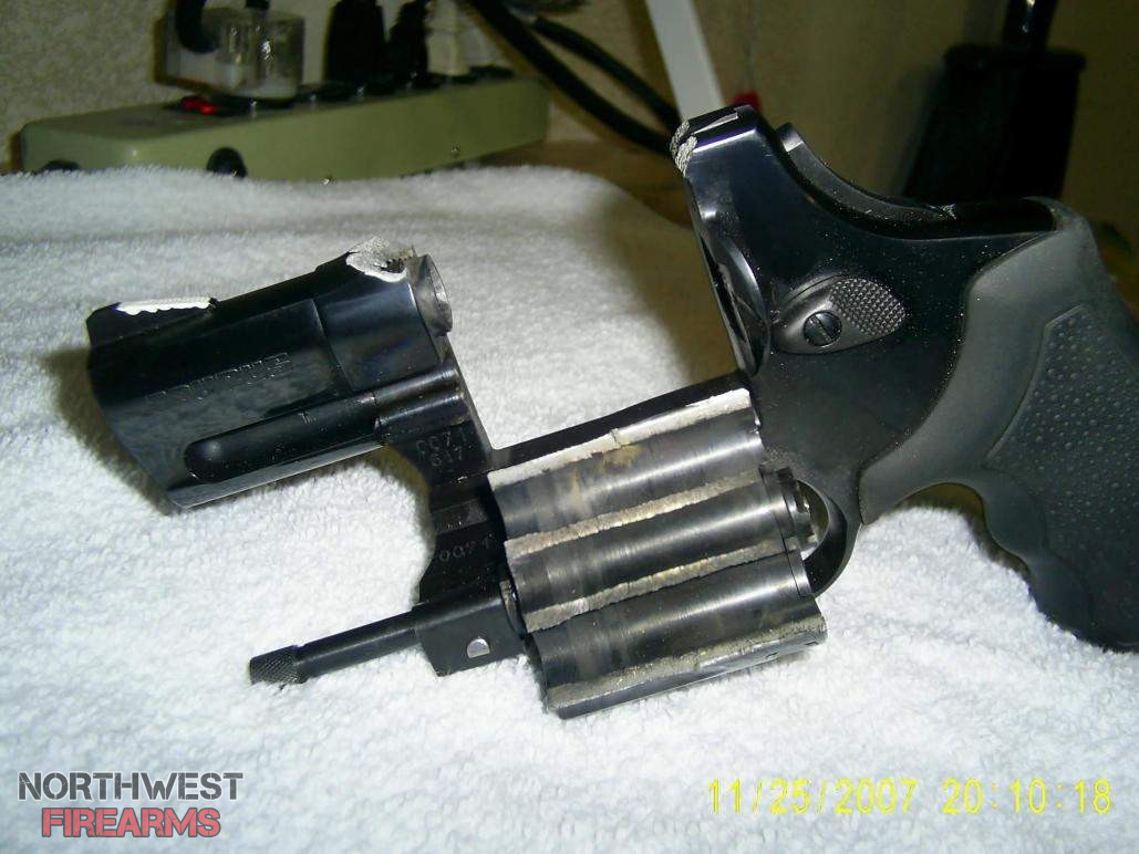

I hate to say it but, this is much less likely to happen in a revolver!
Maybe.....
maybe not
So you did. Or did not. Or whichever. OK, you said "much less likely to happen in a revolver", which is a quote and should cover what you said handily, although not a full quote of what you said, but if anyone wants, they can go back and read your post to ensure I am not misquoting you, and if you are referring to a case bulge, high primer or rim blow out, that is generally true. However.... yes they can still, and do, happen. Go talk to any good pistolsmith, or again, go to any major revolver match, although admittedly, a high primer going off accidentally can and does happen in revolvers as well, usually when the cylinder is being shut with some force, it is no more common then it is in an automatic. Actually, again going to a major match, the auto is far more reliable than the revolver. True, both can break down, jam, have problems, but the auto is far and away easier to clear, get back into action, more reliable, easier to repair, etc., so on and so forth. Again, go talk to a pistolsmith.
I've heard "a revolver is more/much more/generally/often/etc., reliable, safer, accurate, sturdier, simpler, than an auto" so many times I should patent it and charge for the use. While a revolver is, generally/usually/often/normally/sometimes (want to cover the bases so you don't nit pick) simpler to shoot, just point/pull, usually/generally/often/normally, there are exceptions, and they DO jam. Clearing a jam is MUCH harder, (had a new Ruger DA revolver do that on the first cylinder full, so I know that part too), and if a bullet gets jammed in the forcing cone, that is a real fun fix! Not especially hard, but cutting the bullet in two can be a pain and takes time. Oddly the bullet stuck in the barrel is fairly straight forward, but the gun is down again too, yes, for both, but pulling an auto barrel is normally/generally/often/usually easy and if you have a spare barrel, say in the same or a different cartridge, the gun is back in service in moments.

It definitely takes an overcharge to do that to a revolver. I've personally tested this with an old Taurus 38 special. It took a quadruple charge of red dot powder to produce a result like this. 2x and 3x charges wouldn't do it.
My point is that most revolvers are far stronger because the cartridge is surrounded by steel with no feed ramp and there is no such thing as an out of battery ignition. Also, a high primer usually makes it noticeably more difficult to close the cylinder at all.
