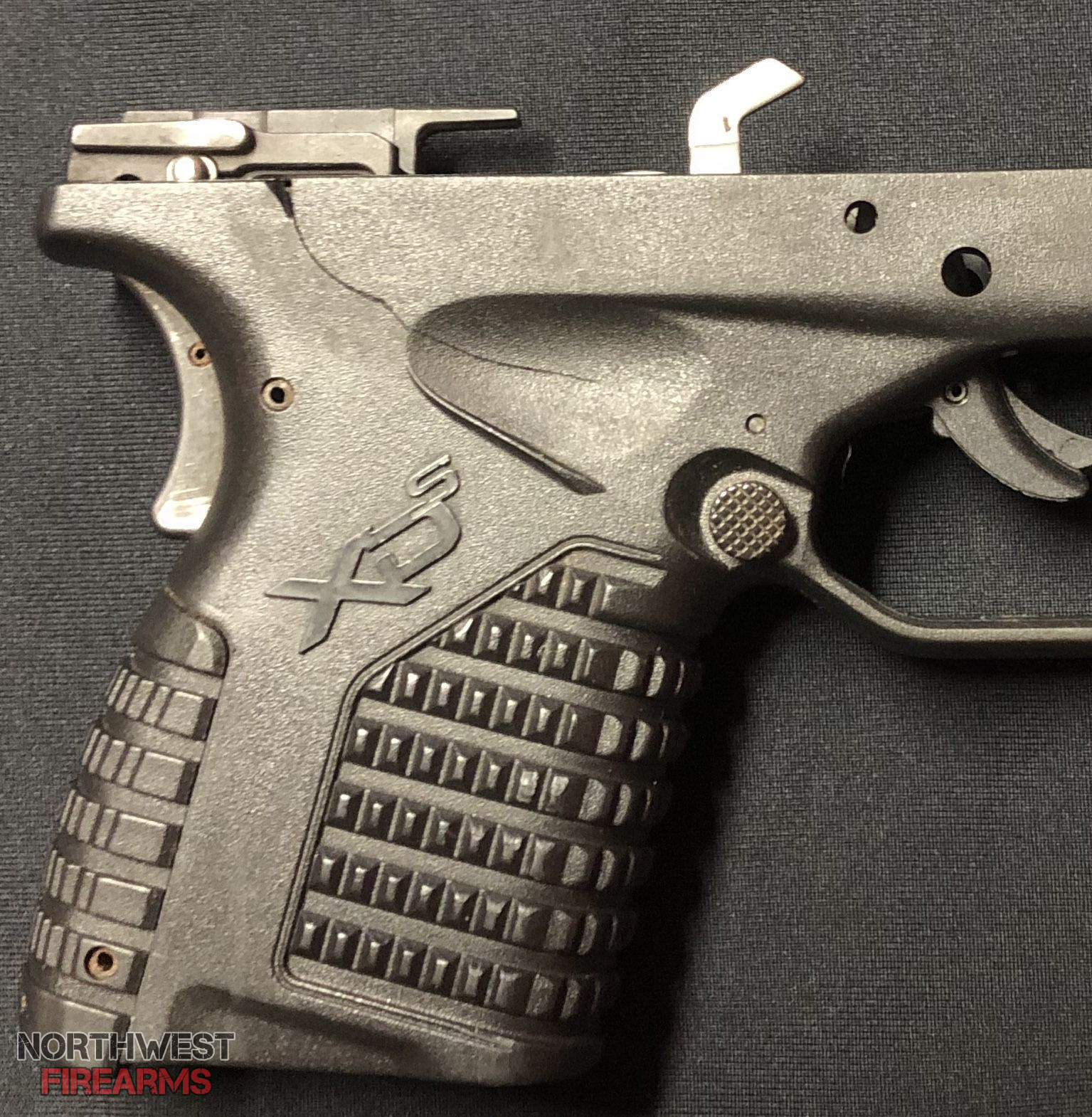

I have seen this kind of blow out with ammo. Reloaded ammo. So my bet is ammo was somehow bad from factory. The primer being gone sure looks like over charge. As mentioned I would expect the ammo maker and gun maker to both point fingers at the other but, would have to hope one of them will give you a new gun. If not it would be a waste of time to go to a lawyer. None are going to take the case free and what you would have to pay to sue would be many times the price of the gun. So keep the ammo that was going in, the blow case, and pics. Then start with both Springfield and Win. See if one or the other will make it right. Just damn glad you did not get hurt.
Yes it is a testament to Springfield that you are not badly injured. Like the others I think it is Winchester's fault'

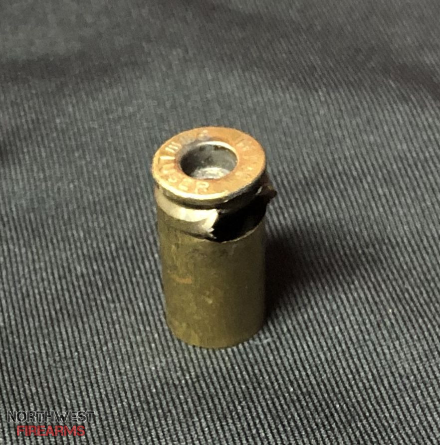

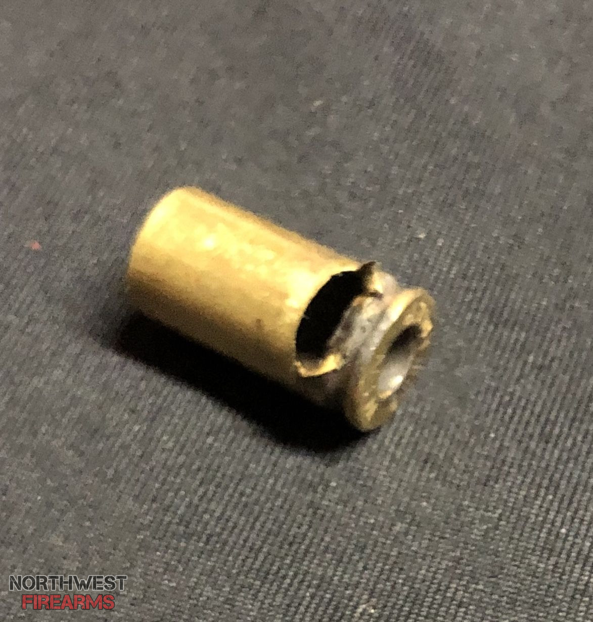

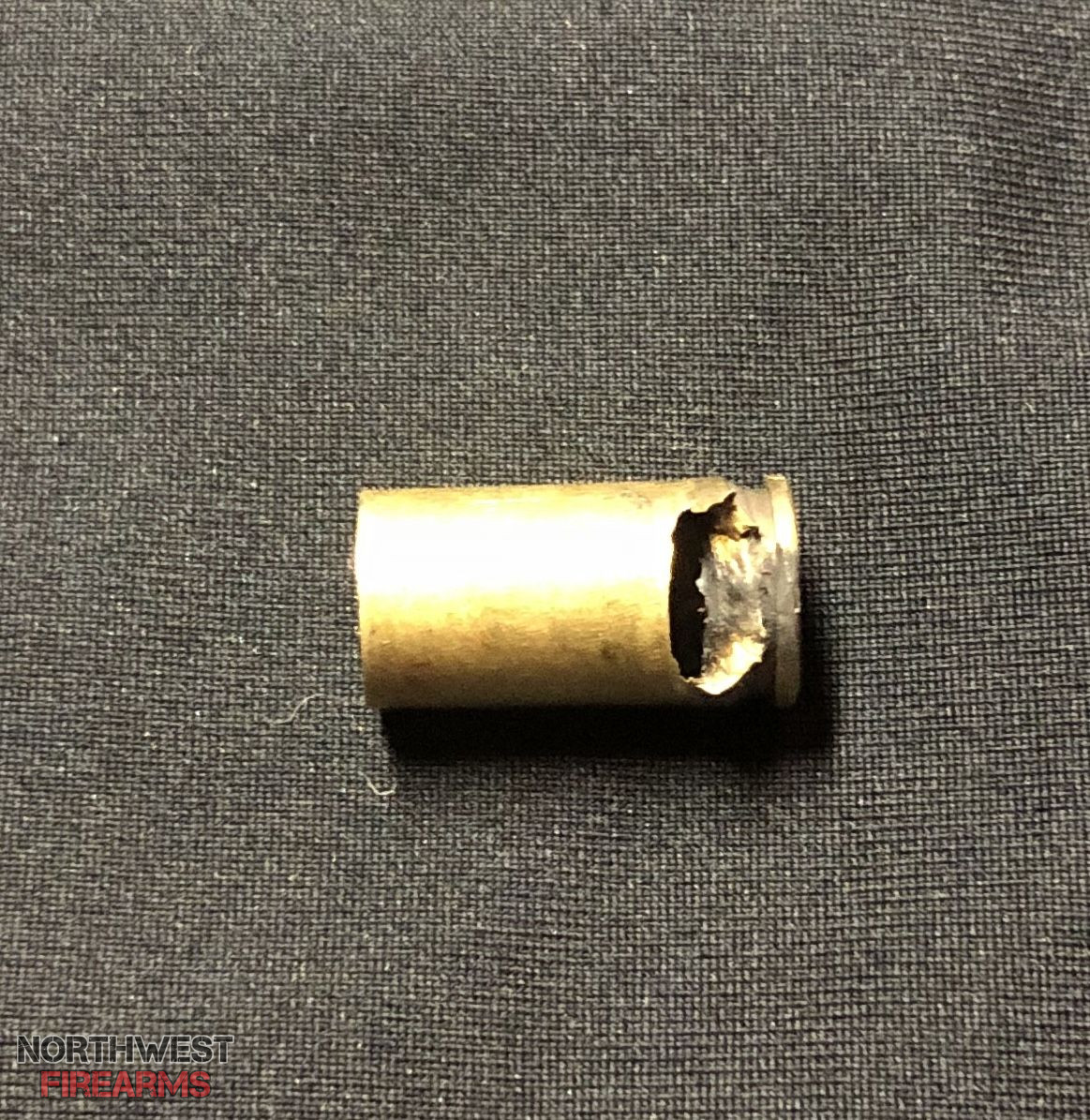

Round was double charged from the factory. Primer blown out, case stuck in the chamber, unsupported portion of the case failed, enough energy left to destroy the firearm. Waay tooo much powder.
I also believe the handgun should have been capable of containing a catastrophic ammunition failure without self destruction. Not sure I would want to shoot another of that make and model.

Pulled the trigger on my EDC pistol (XDS 9mm) today and it went KA-BLAM in my hand. My face got peppered and my right hand felt like it did when I forgot to drop a firecracker when I was a kid. Other than a bruised trigger finger I walked away.
I had to push the stuck casing out from the muzzle end and then it was a bugger getting the slide off (I found severe swelling of the frame). I also found a crack from the trigger opening to the right hand side magazine release and a HUGE crack on the frame at the top of the right side on the grip.
I've attached pics of the frame and the casing that was stuck in the barrel so I can get input from you all before I contact Springfield. The warranty does not cover defective ammo (this was factory, not reload). I have no idea where the primer went but it was gone after the KA-BLAM. The ammo looked fine when I loaded the magazine and came out of my dry gun safe.
What do you think? Was this due to the ammo or?

I would blame both ammo and weapon, ammo was over pressured because of bullet set back.
I would see if there is proper crimp on ammo. I would see how much effort to remove bullet,
with puller? How much pressure to shove bullet into case? What does case at crimp measure?
My two guesses would be, 1 bullet got set back while being chambered. 2 cartridge was abused
somewhere in it's life, causing the bullet to be drove into case.
As for what concerns set back presents, it can cause chamber pressures to increase unpredictably, and potentially to dangerous levels. I think a good example of this is, Speer did a test using a 9mm cartridge. they developed a normal load that was producing a reasonable average pressure of 28,000 cup at a given OAL. Then they used the same load, but this time they seated the bullet .030" deeper. The result was pressures went to 62,000 cup, that's over double the pressures as opposed to the original OAL.
The case blowout seams to be at the unsupported area of the feed ramps.
So the bolt slamming the back of the cartridge, forcing the bullet into the feed ramps and chamber.
could cause setback to a cartridge. Raising pressure too the point of taking the path of least resistance.

Not having time to read 3 pages of replies, I was shooting a few years back and encountered something that looked much like this.
He had this happen to him with a Sig1911, and the spent case looked like a hacksaw was taken to it, in the same area you experienced.
It was a very clean shear, not large and ragged like yours.
His hand was just blackened, and it was determined by Sig that it had fired out of battery.
Hope this helps
