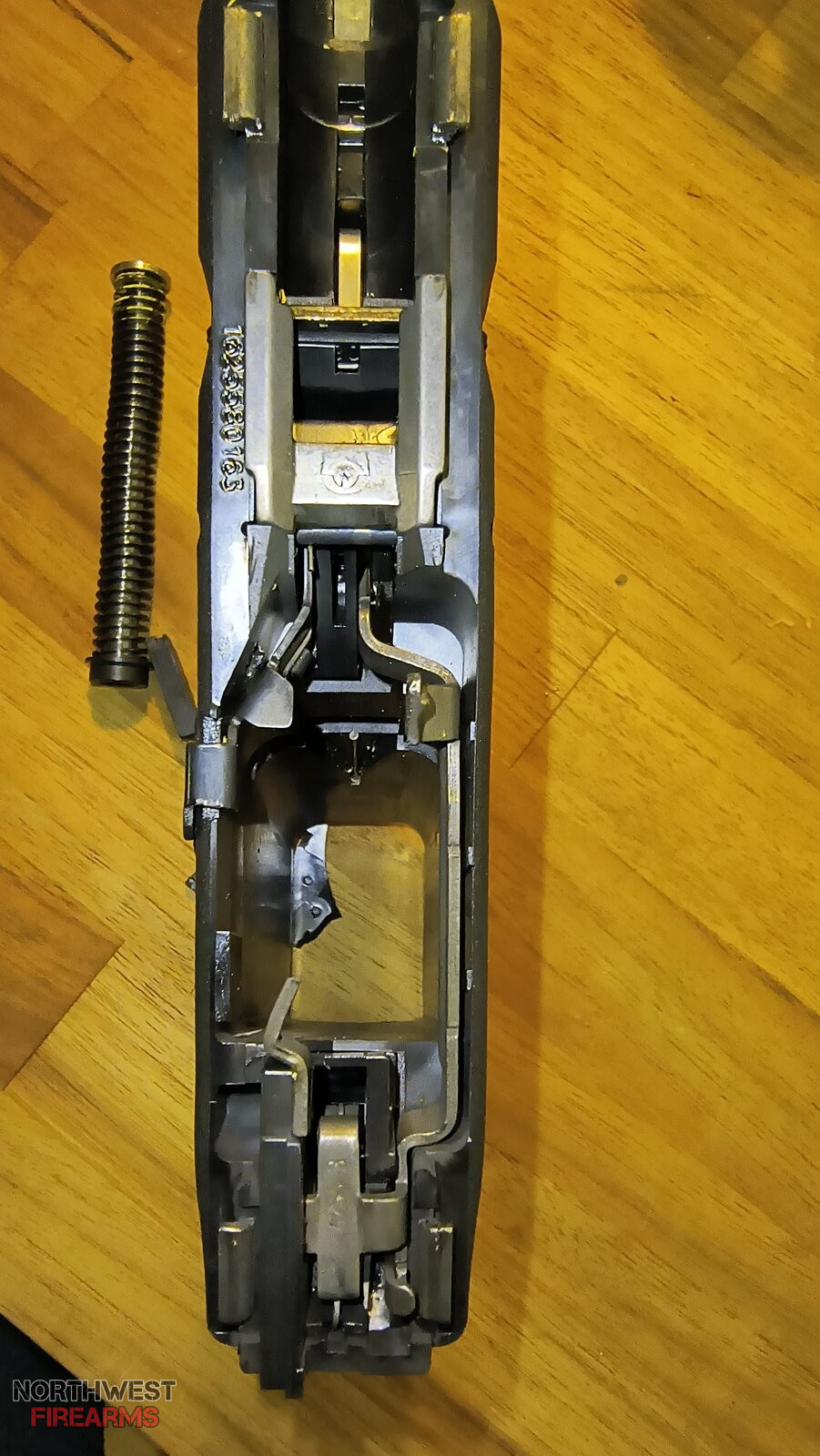

200gr Moly hard cast over 10gr of Longshot. Oops.
I run 8.2 grs of Longshot with a 200gr HC bullet. 10.0 grs is way over max.
Yah, I'm OK, otherwise there'd be photos of digits missing, etc.
I did a work up of 8gr to 10gr. It was getting progressively snappier but more accurate with each step up.
I'd check the ejected cases for Glock bulge, because, compared to my CZ or Ruger, it IS an unsupported chamber.
Loaded four 10gr bullets into the mag and the first one out the pipe ejected the mag, plus mag release and the trigger shroud.
Guess I'm inspecting, and if it passes ordering a lower parts kit.
New or used brass?
Once fired.

Definitely a brain fart. I dunno WTF I was thinking....

Or a tighter aftermarket barrel and new brass and anything that could prevent premature opening of chamber. When running super fire hot loads, factory glock barrels might not be best option.

But I'm not having any of that. If this sucker is still serviceable, it's getting buffed out and put back in rotation.
I'd say this was a good outcome all around. No injury, pistol may be repairable.

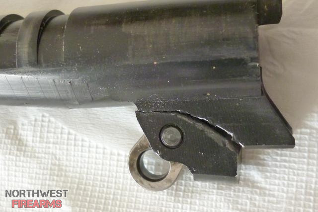

I have been a witness to and /or a participant to a couple 10mm kabooms and mini-kabooms. The 10mm is an intense cartridge when loaded to full factory levels. I cannot imagine purposely pushing that envelope. In fact, if someone is at the range with loads over max, please let me know so I can remove myself from the range.
Ruger 1911 10mm kaboom.
Glock 10mm mini-kaboom...
