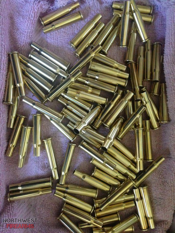

The snowflakes did us a solid:p. As luck would have it I just pulled a batch out of my tumbler. One hour swish and soak in the open nature stuff without pins and one hour spin in the cabelas tumbler with some cabelas polish and 350 .38 and .357 are ready to go...
If you want spotless pockets and clean inside use the pins in a rotary for an hour or so. But these are more than good for revolvers and they look impressive when loaded. They'd load and shoot fine dirty but I like a shiny case they drop right in the cylinder.
