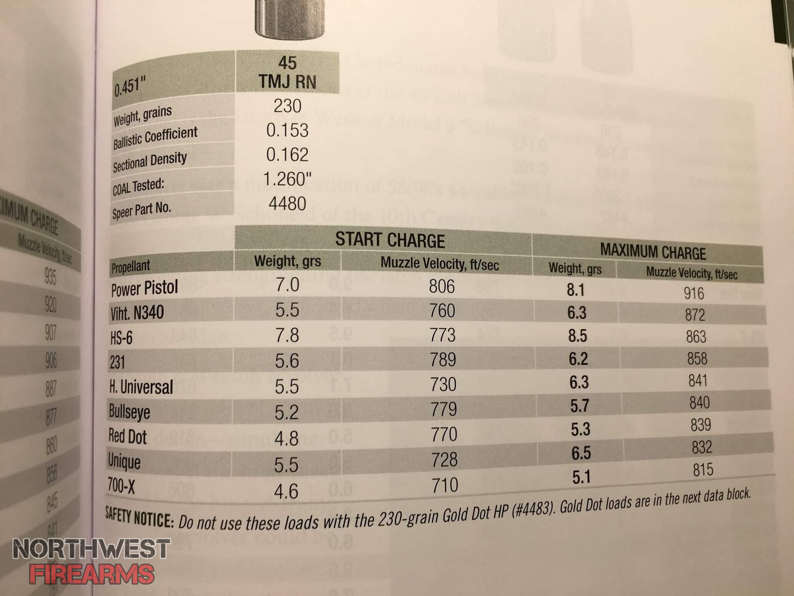

BTW:
Speer #14:
Hornady #10:
Notice the OAL differences?
Speer puts 1.260" while Hornady runs 1.210"
Meanwhile your book says 1.200" and runs less powder than all of them. There is a correlation. Deeper seated bullet = less powder used because there is less volume in the case.
