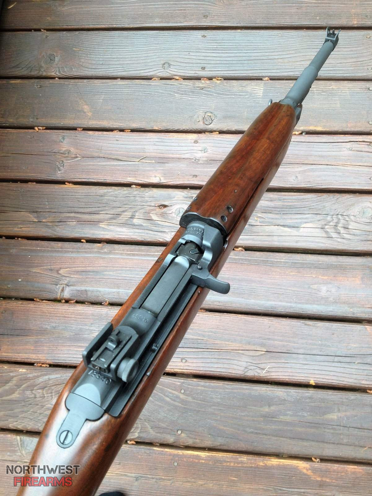

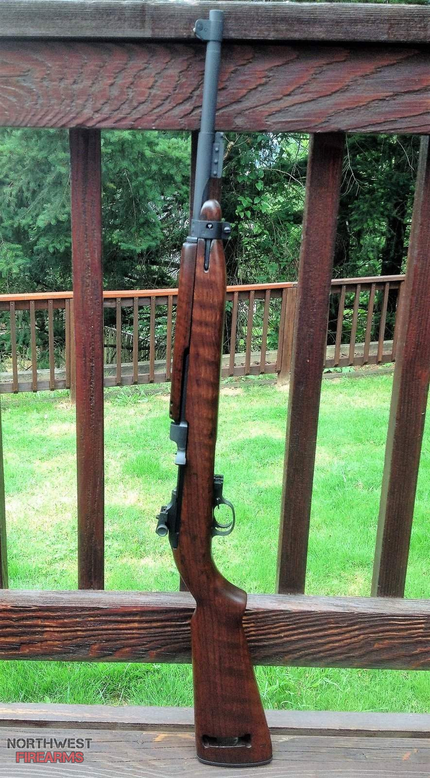

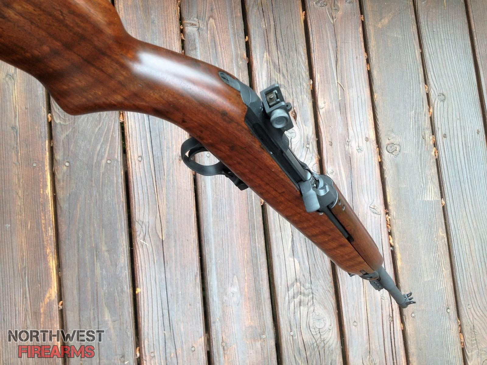

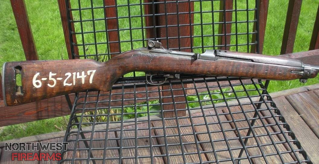

This is a story about a worn old five digit Inland being given a new life.
I did the stock. And Velzey did the re-park.
If you need an old War Horse refinished? His work is Fantastic! :s0155:
Before and after shots.
Old busted.
New hotness.
IMG_0902 (2).jpg IMG_0904 (2).jpg IMG_0907.jpg IMG_0910.jpg IMG_0912.jpg IMG_0911.jpg

Thanks Andy.
Believe it or not I'm still far from upside down on this one. :D
And you talk about done right?
Every part of this gun was taken down and Parked.
Triger group and all it's parts broken down. Including hammer, trigger, safety and mag release. The front sight was removed so barrel band could be removed. Rear sight was taken apart. And the flat bolt I used to replace the round bolt was also torn down to it's parts before re-park.
The price was fair. And the attention to detail well appreciated.
I cant say enough about Velzey's work. Thank you so much.

The stock that came on mine was the reason I bought it.
It's a early I cut, Rock-Ola high wood that somehow never got cut down [They tended to split. So all were cut don during rebuild]. It also had those tiger stripes peaking through under all that old varnish. And years of wear. I didn't even notice the Inland was a five digit until I got home. :s0112:
I refinished this stock once before. But didn't get the results I wanted.
It was so beaten up. That this time I sanded it with 250 grit until I could not safely sand it any more.
Then I threw it in the dish washer and left it there through the heated dry cycle. Just to try and raise the wood and get some of the bad grit filled dents out. :s0108:
After a good dry. I finish sanded it with 600 grit. Then stained it with my own custom blend. And coated it with BLO.
Lots of fun. And I already have another one to get started on.
