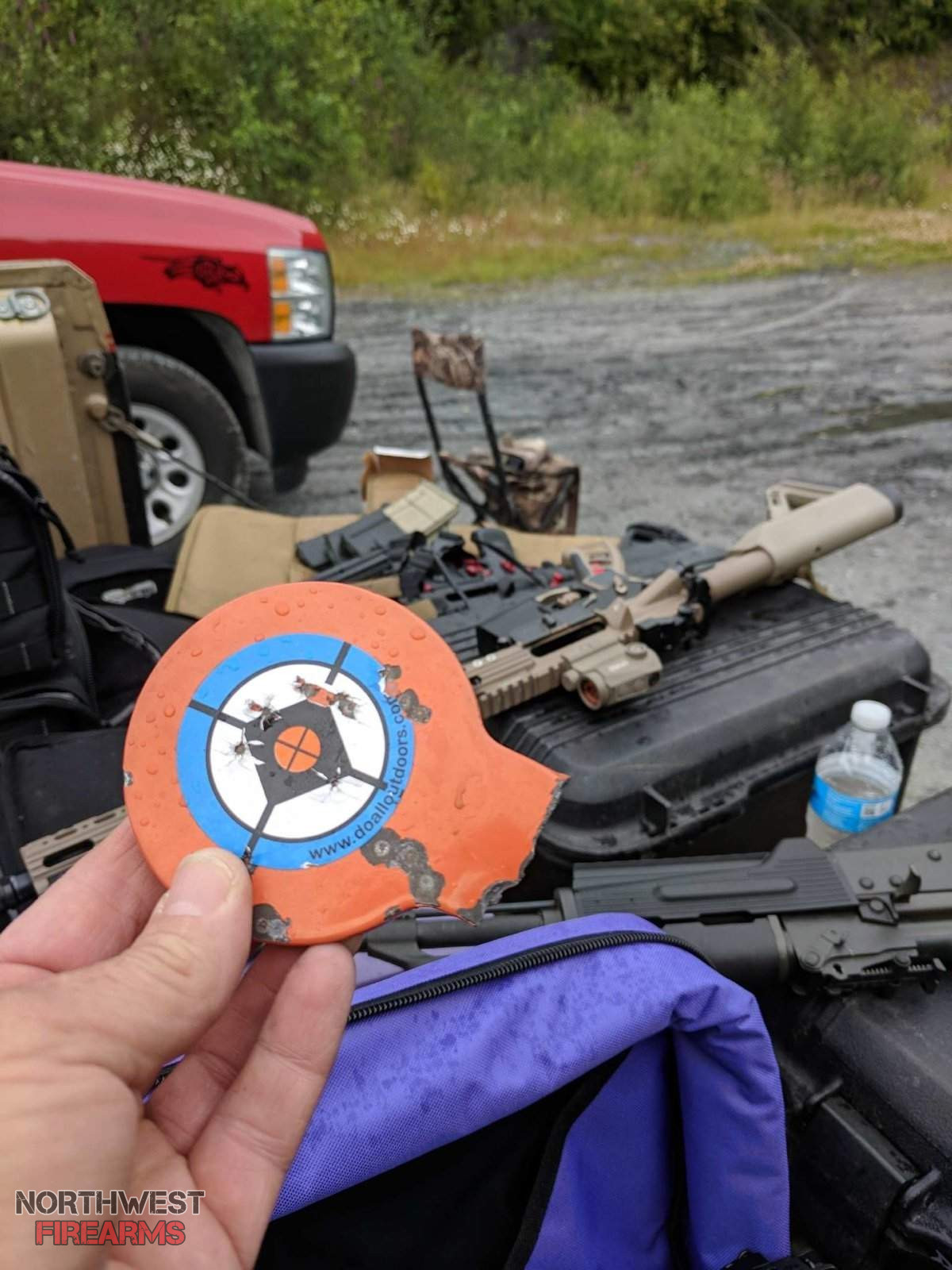

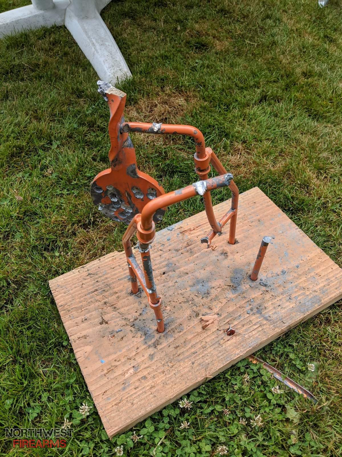

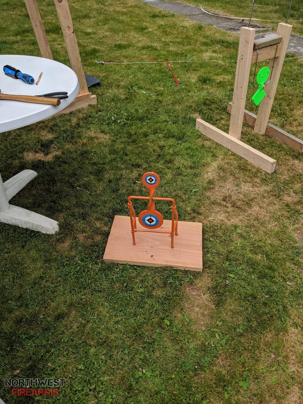

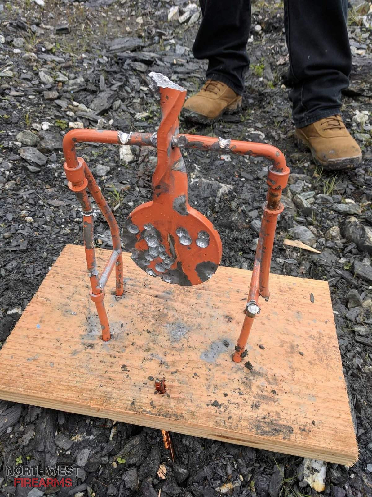

Lol granted it was only 25 or 35 bucks .but it said would handle 30.06 but a few hundred Rounds of 5.56 and we destroyed it.
Pics . BEFORE AND AFTER
