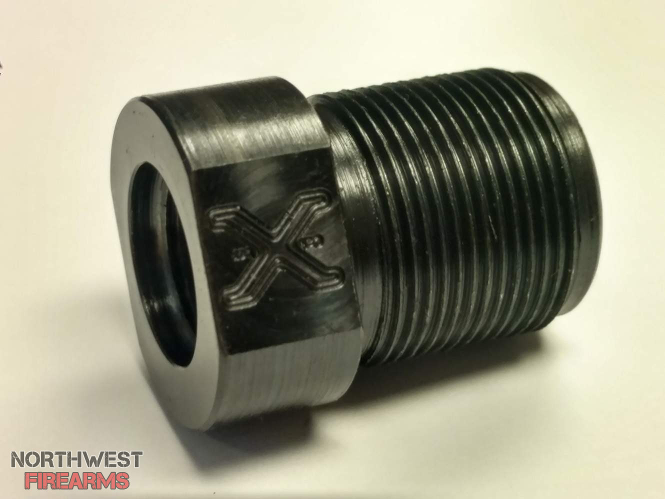

Adaptors will work for this. Similar to this one. Easy to make an even more low profile than this one.
