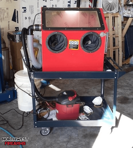

Blaster setup:
it has a vacuum below that goes through the dust separator on the side so you can see what you're doing, and to keep the blast media out of the vacuum. Cleaning literally takes seconds per baffle. you're done with the whole thing in less than 5 minutes.

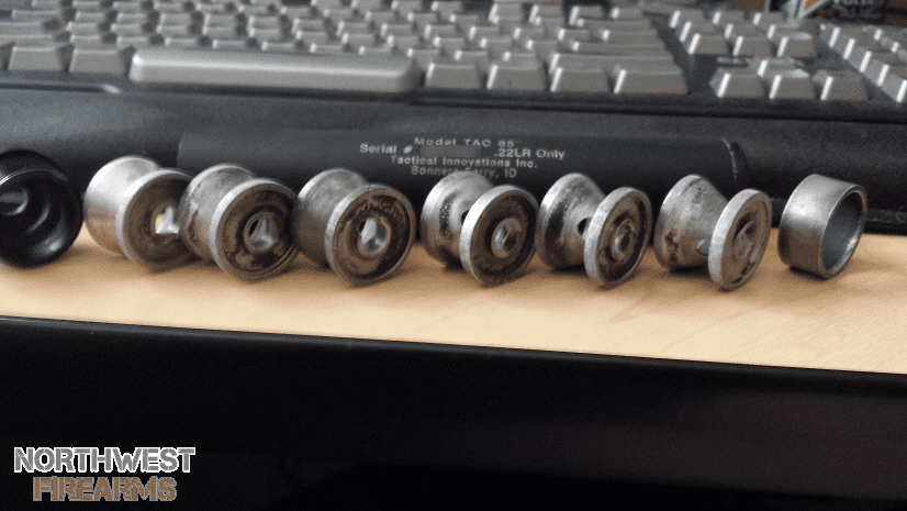

Before cleaning:

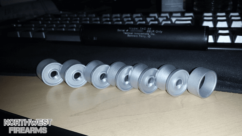

After cleaning:

and finally a baffle removal tool AAC makes one... it threads onto the endcap and gently presses out the entire baffle stack at once...Absolutely do not use a hammer to drive out the baffles cause if you screw up your tube: your effed... the press is the safest and easiest way to remove baffles that are stuck in the tube which is not uncommon with .22lr suppressors... They get lead and gunk built up in them pretty quick.
Also don't sand blast your anodized tube. Just use a paper towel with soapy hot water for that bit and the end caps...the baffles themselves as long as they aren't anodized: blast em or tumble them or whatever method you choose. This is just how I do it.
I did buy the blaster originally for the can, but then I found other uses for it as well. Buddy also used it to restore firearms that had barely survived a barn fire and had a lot of smoke and heat damage.
Blaster is just a cheap harbor freight blaster. (you may need to clean up some casting flaws in the blaster gun to get it working well)
dust deputy (dust separator) I got used off of craigslist.
vacuum is harbor freight
drop light inside blast cabinet is also from harbor freight and magnetically attached to the top.
cart is harbor freight as well lol
