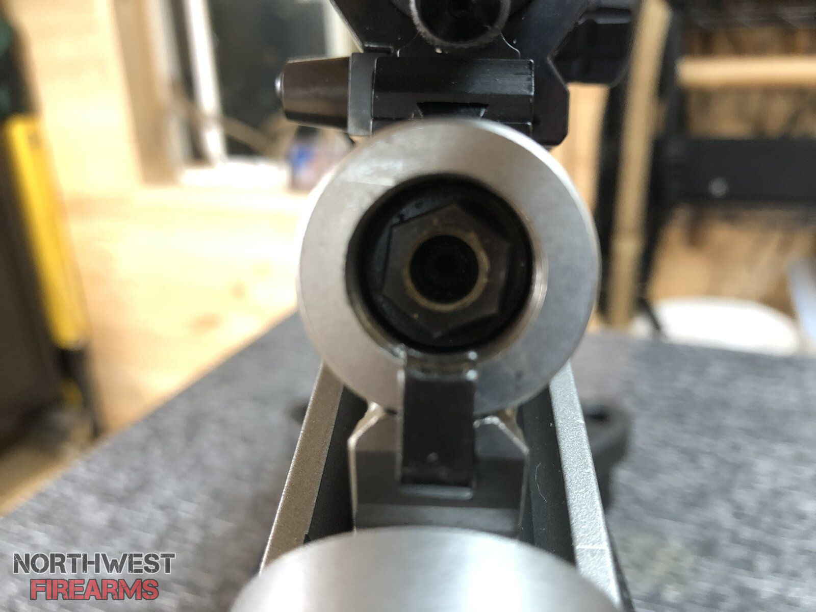

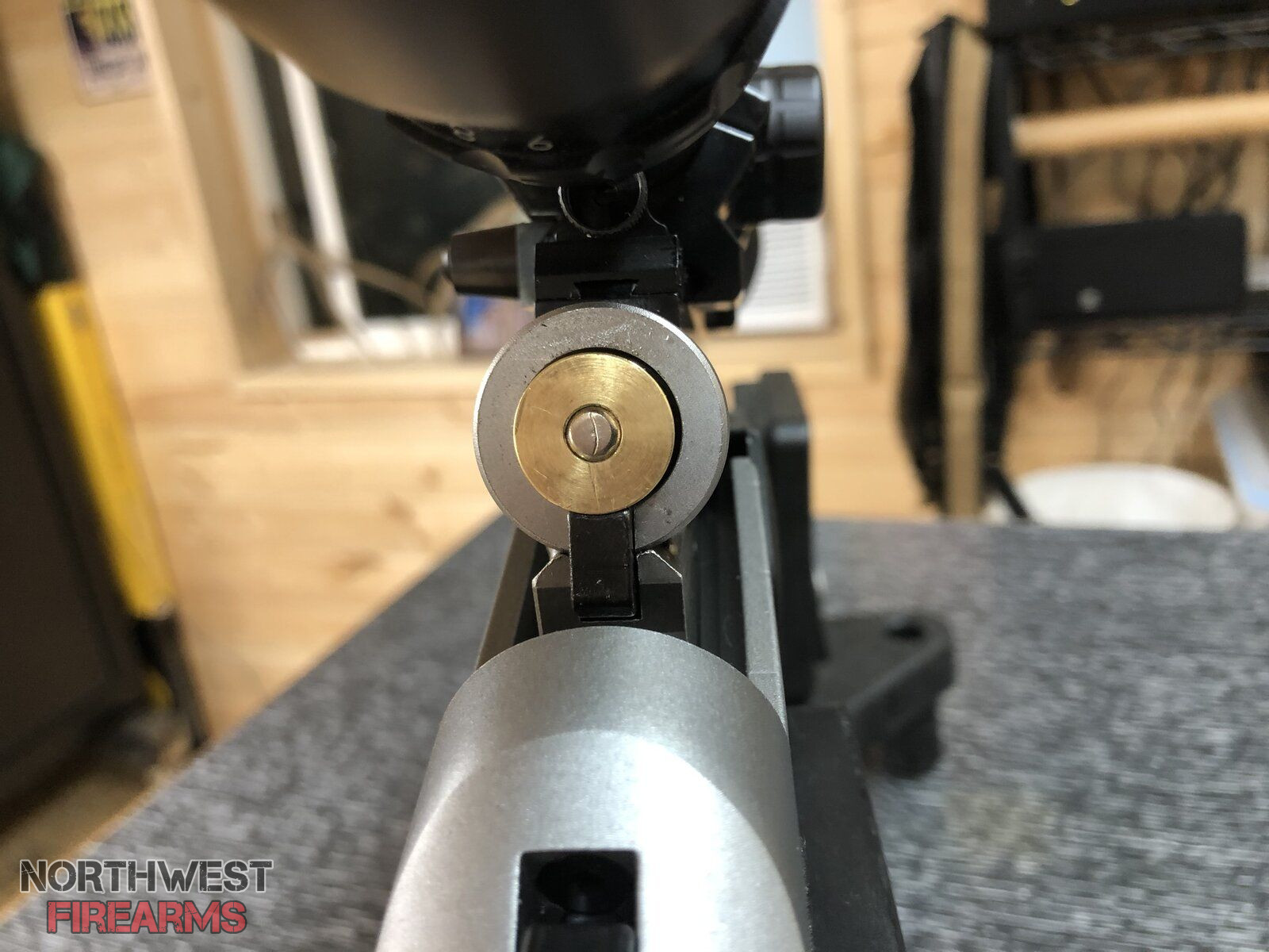

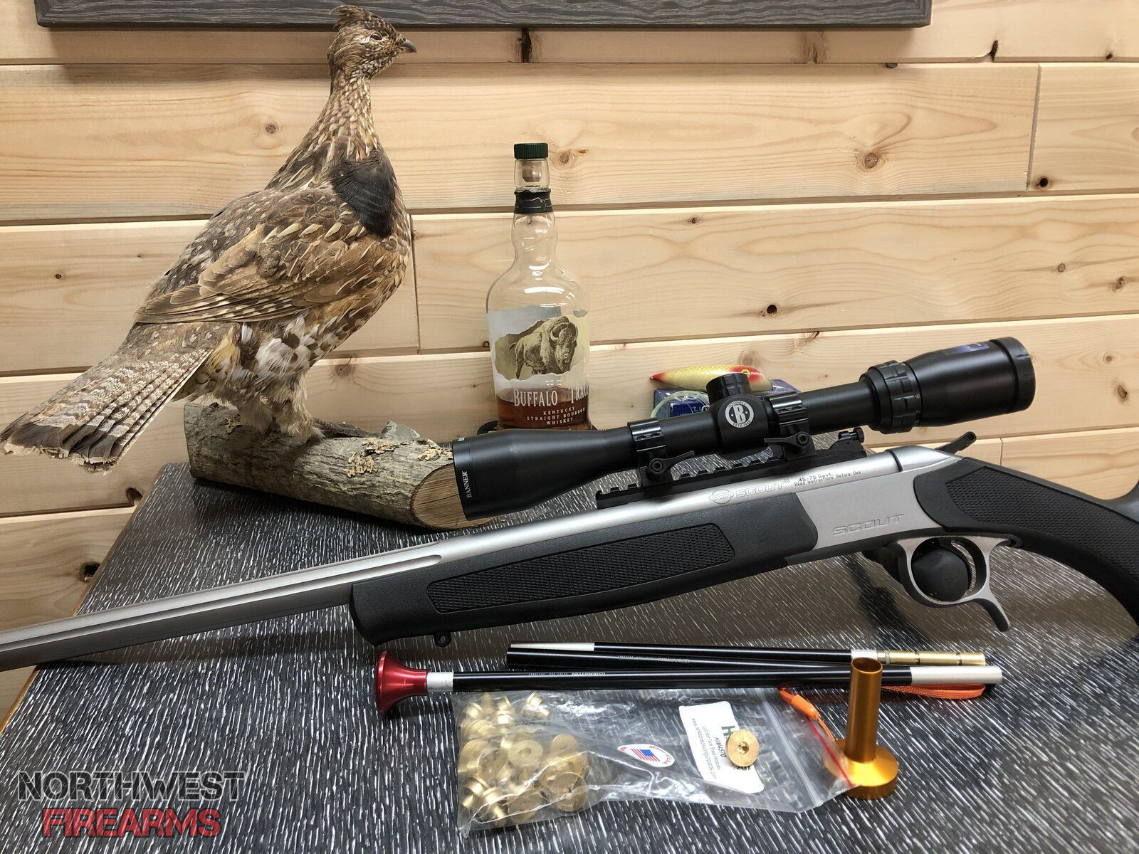

Does anyone here have experience with smokeless muzzleloaders? I bought a Cva scout v2 single shot in 45-70, with the sole intention of sending it out to have the breech threaded to accept a plug that turns it into a smokeless powder muzzleloader. I sent the barrel out to Jeff at Hankins Precision Rifles and got it back promptly with all the necessary mods and trinkets. So far the mods look well executed. The breech plug accepts a brass primer module that fits a lr mag primer for ignition. So basically you pour 55-65 gr of imr 4198 down the bore, followed by a properly sized 250-300gr 45 cal projectile. The velocities that can be achieved are shoulder numbing. :confused: I ordered a smooth form bullet sizing die from Jeff so I can try various bullets to find a good combo. First up will be some 300 gr gold dots. I should even be able to use it for true ML seasons here in WA if I also develop a load with Bh 209 powder and put iron sights on it. Anyhow I am looking forward to shooting this thing soon to see what it is all about. I will try and post some pics this eve.

Here are some pics of the beastie.
56D8AA44-80B1-46A5-B40C-F859AB779E98.jpeg CB2370DC-781D-4BCD-AE2E-84C1FE36FEF8.jpeg FCE784AE-2CB3-4E4F-803A-72162DC9ACCD.jpeg 4F61B179-26CB-4E09-B34F-68F2A98CAC37.jpeg 6FF29626-94C4-4131-AE96-7A2F8C452D5F.jpeg 3CBB4B51-7544-4521-9FB9-1E092464E83B.jpeg :oops:
First outing was short lived as I torpedoed my shooting session with self inflicted mistakes :confused:. I failed to adequately bore sight, so after 5 shots with no clue where I was hitting at 50yds, I pulled breech plug and bore sighted. I then loaded back up but had forgotten to reinstall the breech plug.:mad: Despite concerted efforts the clear loose powder from the action and breech threads, I could not seat plug correctly to close action. Game over. Took it home and corrected and double checked bore sighting. The 5 shots I took were with 50- 55gr of imr 4198 and 300 gr gold dots. Ignition was instant and recoil was fairly mild. Hoping to get back out soon with hotter loads and chrono equipment.

Smokeless powders generate too much pressure and you would get blowback with loose primer pocket. Also the way I have it with a threaded in breech plug, if I use blackhorn 209 or similar I can hunt with it during ML season in WA. I thought about doing just like you proposed but those are the reasons I didn't go that route.

Yes the machined brass adapter modules with preinstalled primers fit in and are seated with the snapping close of action. After firing the extractor will unseat module from breech. It is pretty slick really.
