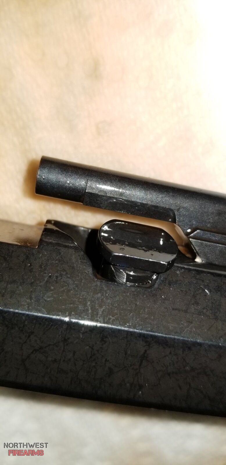

I found this spot rubbing on the BCG.. cant seem to find any other strong indicators other than that ejector is very, very stuff. Let me know what you all think as I let the BCG soak. Thanks!
I wouldn't soak the entire BCG unless I was planning to disassemble after the soak.
I'd take it apart, clean and then reassemble.
You could also check the ejector and its bore completely while you had it apart.

An update: I called BCA just to see if they as the manufacturer had any input. The immediately sent me a shipping label and said to send the BCG back for inspection / replacement. He asked for any photos I had and I gladly supplied them. I'll update again when I get a BCG back from them. 🍺🍺
