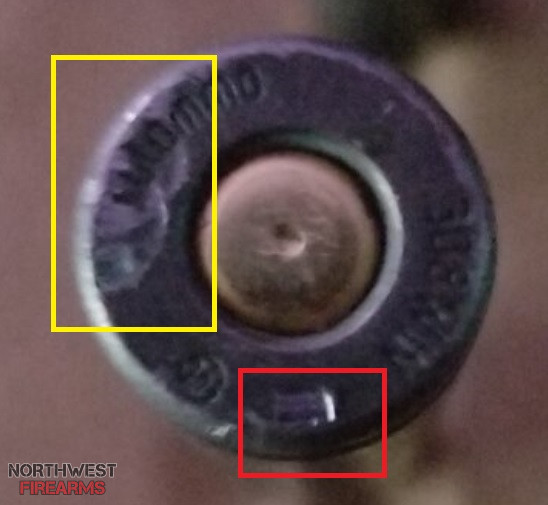

I've never run steel case ammo in my lr308 but your cases look rough to me(ejector smear(yellow) and a gouge left by the extractor(red). I would agree with some others that you probably aren't getting back into battery for the second shot for some reason. If you've never had a failure on your first shot, and the trigger is resetting before the second attempt, I think you can rule out light primer strike and trigger spring issues. If those were the case you would see the issue when manually charging too. Could be under gassed and short stroking, or maybe there is an issue with the bolt lockup. Here are some tests you can try to isolate the issue.
