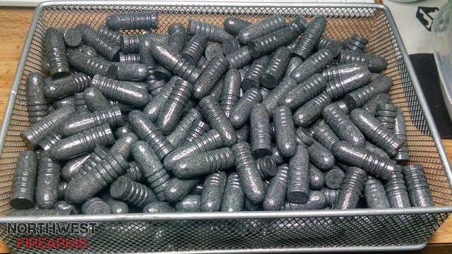

Let's post our PC'd bullet pictures
These were done using this method
How I Powder Coat bullets
What's the purpose? Just to be different?
PC (Powder Coating) and Hi-Tek coating are polyester/polymer coatings applied to raw lead bullets that encapsulate the bullet and works as a lubricant. PC and HT coating replace the need for messy lube and alox that can gum up your loading dies and cause extras smoke when fired. Both are allowed in most indoor ranges where lubed bullets are not.
Hi-Tek coating has been by commercial casters in Austrailia (where it was invented) for over 25 years and used extensively at IPSC matches.
There is the health advantage if you cast bullets, once they are coated you are no longer handling raw lead.
Coated bullets keep your barrel cleaner (when you use the proper alloy and size bullet)
These coatings are not a cure-all, coated bullets can be pushed up to 1800 fps w/o gas checks and near 3000fps with gas checks, proper sizing, and alloy (copper is added to make the bullet more ductile.

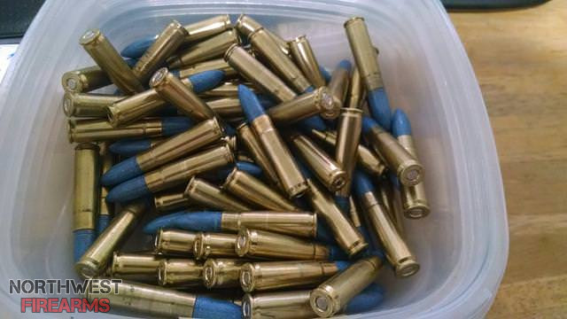

you can use different colors too:

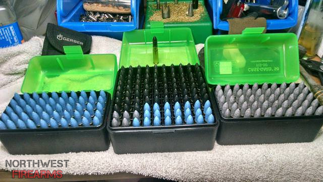

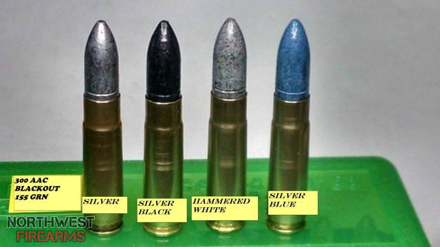

differentiate different loads.

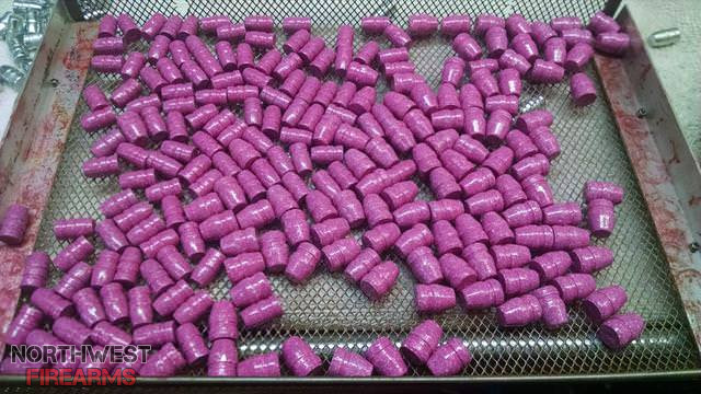

spice up your cartridges (the pink and the bags are PC the rest are HT
make your bullets more "girl friendly

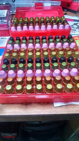

and you can do the lone ranger look
Those look really good. I'm planning to eventually cast and powder coat my own bullets - have most of what I need to do that now. I know there are at least a few folks on this site that do powder coating of bullets, one that comes to mind is @Benchrest. Maybe he'll be interested in offering up a few photos.
I really like the idea of easily distinguishing different loads in the same cartridge - nice way to keep easy track of what you're shooting.
Moly? How do you do that?
For hi-tech you use either a two part liquid formula or a powdered version with acetone and add 5-6cc to 5lbs Bullets in a small bucket, shake for about 15sec to coat, spread out on a mesh sheet to dry, then bake at 200c (about 380-400f but my oven controller is in centigrade) for 8 to 12 minutes in a small convection oven. I usually do one coat, size with the Lee push through dies then add another coat.
