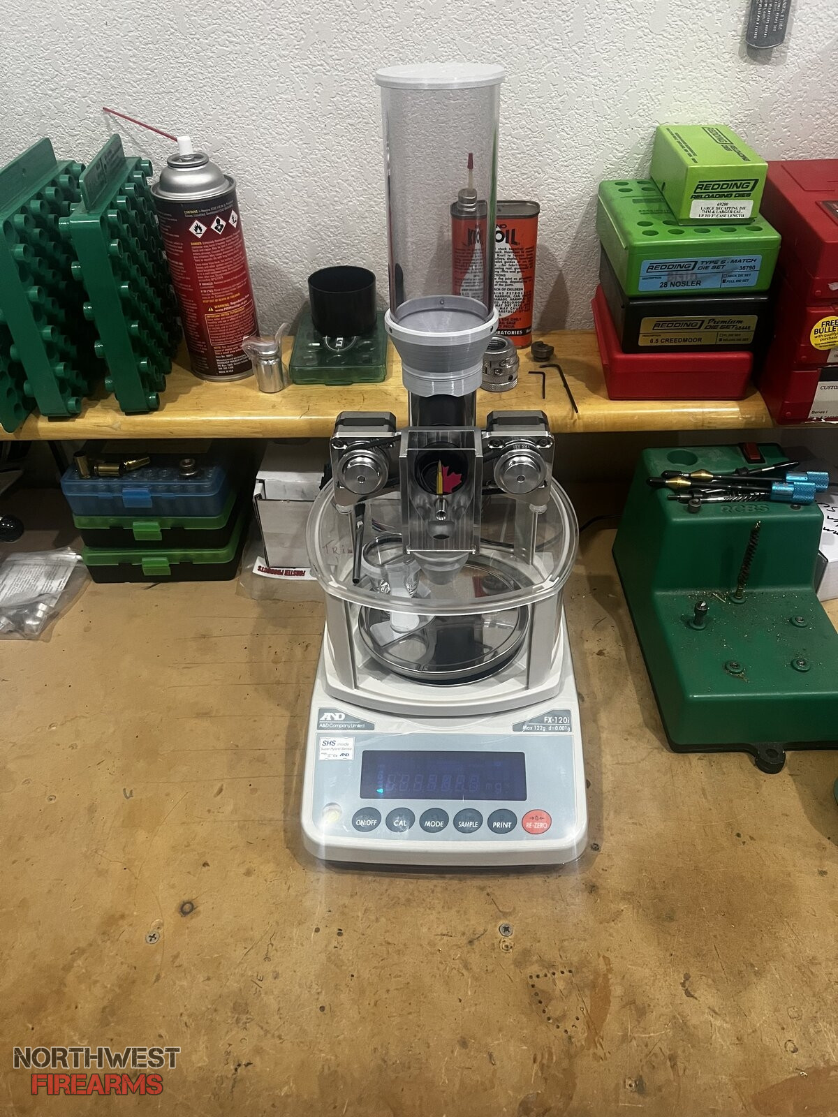

Well finally upgraded my scale to a V4. Looking forward to seeing the ES drop…
How does a better scale decrease ES?

Im curious what kind of measurement accuracy the V4 scale gets that reduces ES.

I'm curious what kind of measurement accuracy the V4 scale gets that reduces ES.

Yeah, I'm not sure the difference it will make but the unit says it goes to 0.001g so maybe it's just that much more precise. Though I myself don't see how going that next digit down will help much. As long as you keep the unit stable and recalibrate it once in a while(precaution/maintenance), I'm not sure how far off the mark you can actually get with a digital scale.
Thats the root of my question. Most scales go to +/-0.1gn and many shooters get very low ES from those scales, I suspect there are other things that affect ES than just minor variations in charge weight.
I realized the scale says g not gr so that would make it ~0.015gr and yeah I'd have to agree that there might be something else.
For g it is .001 for gr it is .01. Coming from a chargemaster Ive had for 10-15 years there is a definite difference .1 vs .01. I loaded some load work up for a buddies .300wm and my 28N, and I would say my chargemaster was about .2 gr low. Ok fair enough. But out of 20 loads I found 3 or 4 that were well outside of -.2 what my old chargemaster claimed. Granted I like RCBS, but I trust clinical scales that are rated higher a lot more. I look forward to seeing more data and will update.

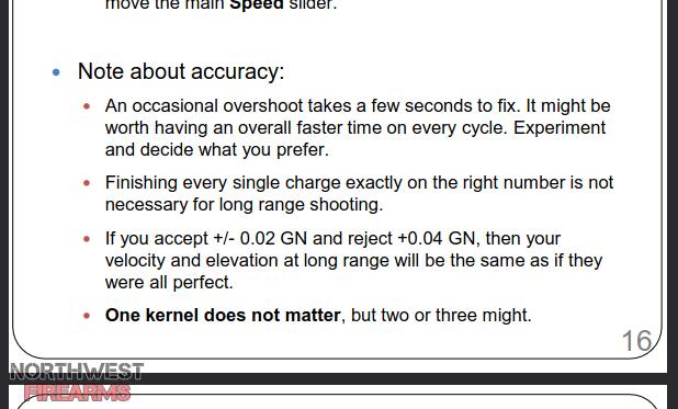

I found it, the V4 instruction manual says its accurate within +/-0.02gn charge weight.
as for its effect on ES: +/- 0.04gn wont matter. My guess is +/- 0.1gn would start to show up on ES so having a scale that is accurate less than half a grain could be beneficial to improving ES. It would at the very least be one less thing to worry about trying to lower ES.
