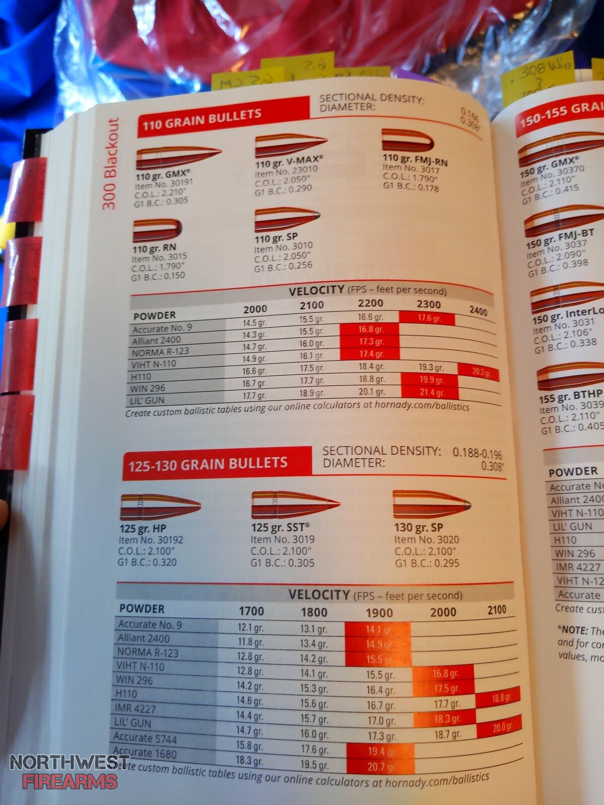

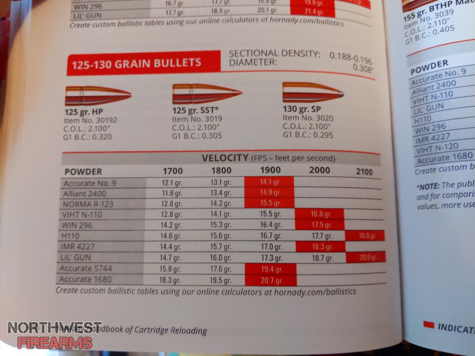

Here's hornady 10th ed. For that weight. Notice the grouped 125 to 130gn together.. Hence why theirs probably starts out so low at the min. You'll find a lot of sources vary. It also gives a COAL for each bullet all of which look "pointier" than yours = longer COAL.
Fwiw I had the Nosler manual and Gabe it away. Didn't find it as versatile. I heard the Lyman (or was it Lee, pretty sure Lyman..) manual had tons of loads. I find the books that aren't catered by a specific powder or bullet maker has more wide ranges loads that covers more "ground"
Anyway. Sounds like your covered. So good luck and enjoy. If it were me. I'd just shoot those off, and that will help ease your jitters down the road. Reloading is pretty safe as long as you pay attention. The fact that you know they are short means a lot. Its the ones that you don't know are short that are the problem.

weird is my lee data calls for 17.8 starting for lil gun on 125gr with 21.0 max and lyman says 17.0 to 18.0 but only 125gr is the sierra hollowpoint?
i assume eack book has diff value. or they all be the same # right..
Yeah I think I said that. Every source is slightly different but pretty much all in the same balk park. And also worth repeating is some are more conservative than others. I typically don't use the book for max velocity but I go by the saami spec for max pressure and use +p etc where applicable say for 9mm or others. And .308 instead of 7.62x51 because .308 is higher pressure.
