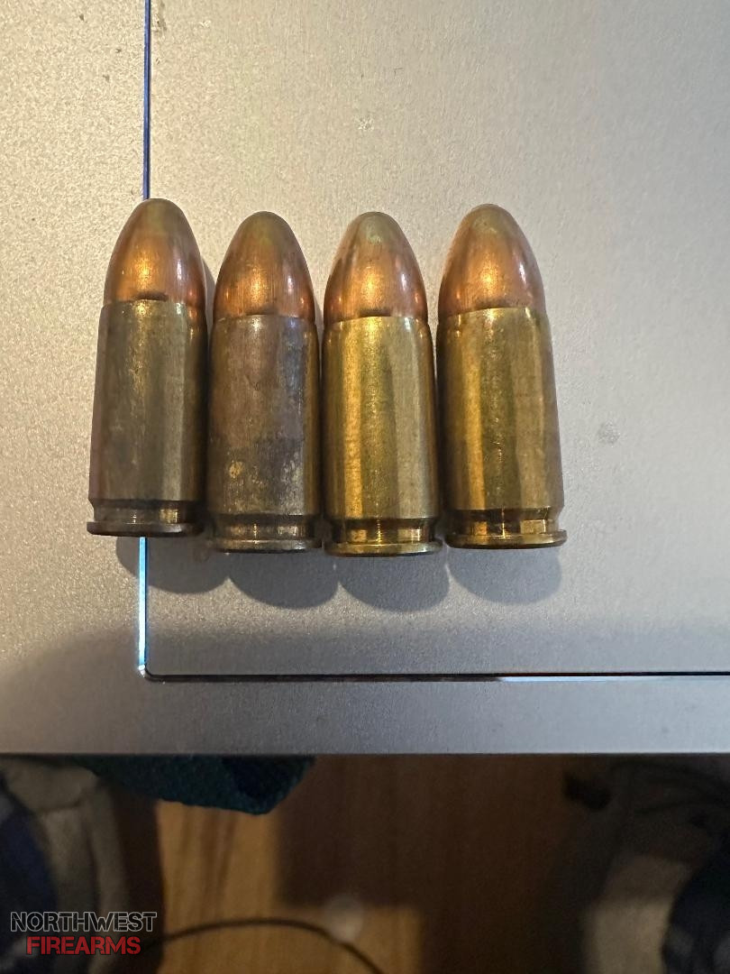

The ones on the left are the ones I was going to get rid of and the ones on the right were the ones I was going to shoot at the range if safe. They were all in the same box of 100. Probably 20 I picked to discard and 80 I was thinking about shooting.
Looking at the picture posted...
I'd probably use a bit of steel wool and give 'em a light cleaning and shoot 'em.
Just pay a little extra attention to make sure they go Bang and exit the barrel.....

I agree that is an excessive looking crimp. If they are handloads I would disassemble them for the components.
If factory ammo and if it chambered without an issue I would shoot it at the range (the steel wool is a good suggestion).
A good point was raised by the possibility of a squib, I would shoot all the rounds allowing 1 - 2 seconds between shots. If a squib were to occur there is a definite difference in the sound made as the ammo is ignited inside the gun (it's quieter) and you do not want to follow a squib load by immediately firing another round.
No, factory Winchester 115 grain target loads.
Im still skeptical cause those crimps look awfully heavy. 9mm headspaces off the case mouth.

100% not handloads. He's getting rid of all his handguns stuff due to him making a bad selection in the wife picking duties! LOL! I bought a bunch of ammo from him and he threw this in. He threw in some 38 special and shotgun ammo also. But I took the ammo out of the Winchester box it came in. Definitely not reloads.

I'm sorry Koda but you are wrong. They are factory Winchester. I don't know how else to tell you. I'm new to this site but not new to shooting. I'm 64 years old and started shooting when I was knee high to a grasshopper. If it were reloads, I wouldn't even ask the question about them being wet because I wouldn't have even took them. I've been around long enough to know you don't trust someone else's reloads wet or not.
