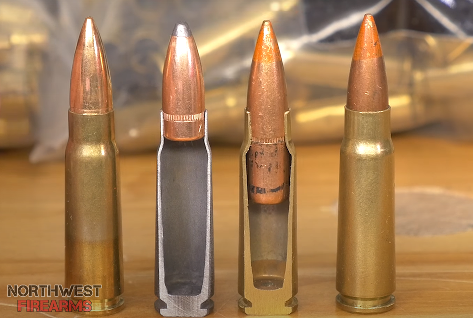

It looks like the "groove" will serve the same purpose as a "crimping groove" or "cannelure groove". There might be another (more industry specific) word for it. But at this point.... "I'm comfortable".
Note......
Some people might say that the grooved or the more pronounced cannelure style of bullet is "less accurate" than a smooth side bullet. Of course quality control has a lot to do with all that. Then, you'll note that a smooth sided bullet is usually found on Match Bullets. So probably.....there is something to that?
And, there is always the issue of possible deformation of the bullet when it's "crimped" into a brass case. Yeah.....one could go with a light or heavy. Or even, a barely there (say close to "slip") fit into the cartridge case.
Of course remember......
Recoil and feeding (from magazine or just placed into a chamber) will dictate much of what you're doing (trying for).
ME.....I don't want the bullet "telescoping" into the case or moving just a little (to change things up).

PS.....the original caption to the photo said the 123 grn bullet was on the left and a 150 gr bullet was used on the right. Also note where the cannelure on the right bullet end up.
So in my case what im gathering is depth can be anywhere? as long as .308 of projectile is in the neck?
see pic. should i be aiming for BLUE arrow, as i thought this was the cannelure area to seat depth.
OR are these marks useless?
is YELLOW A suggested min depth? i havnt mic'd it but seems to be approx same height as diameter.
THE RED ARROW, does it represent anything?
If this was a smooth bullet. i would be most like only concerned with getting at least .308 in the case then shoot for load data or make sure in in saami COAL specs.
Of course i know, after all is said and done, its all about mag fit, will it chamber and will it cycle and shoot!

My biggest concern, and why i posted. Is it safe to shoot?
300BO
Powders at min or very close 18.00 (20.2 is max)... check
Case trimmed to acceptable length 1.350 min....check
Current rounds loaded vary COAL is between min 1.90-1.91max
NOW THE MILLION DOLLAR QUESTION
Safe to shoot?
OR
should i use the vihtavuori load data for COAL OF 1.976?
OR
Am i fine, but may need to seat bullet higher closer to 1.976
my biggest concern is SAFE TO SHOOT and work my way up around the 1.976 on next batch, or scarp it all and Start @ 1.976?
yes 125gr was my base min it seemed as the projectile got lighter on all data i looked call for more powder and same the other way as it gets into 200 plus gn goes down to like 8.0.
i can dial it back to 17.8 if you feel its "safer".
i am just double checking100x before i put my hands and face within 6 inches of this when firing..LOL
Typically from what I've seen is every .1gn increases roughly 10fps. *typically* , I wouldn't worry about it.. And .2 is a very low incremental step. I usually do .3 minimum steps. And up to .4 or .5gn.
most people usually do .5gn steps.
You're fine.

RE : The photo of the case capacity difference.
IF it were me (on my first try).......
I'd be trying for a COAL that matches (or is close enough) to a factory loaded cartridge that uses the same weight bullet.
I don't know what your powder is like. BUT, say it this way. Generally, it's NOT recommended to compress your powder. Yup.......some powders are really "fluffy". While some other powders aren't so much.
Mostly though.......
I would be looking at what my reloading manual says about this particular cartridge (considering the recommended bullet weight and powder combo).
Normally (when reloading ammo)......I don't encourage myself to try to reinvent stuff. Maybe, that is how I've managed to come this far? LOL.
Aloha, Mark
