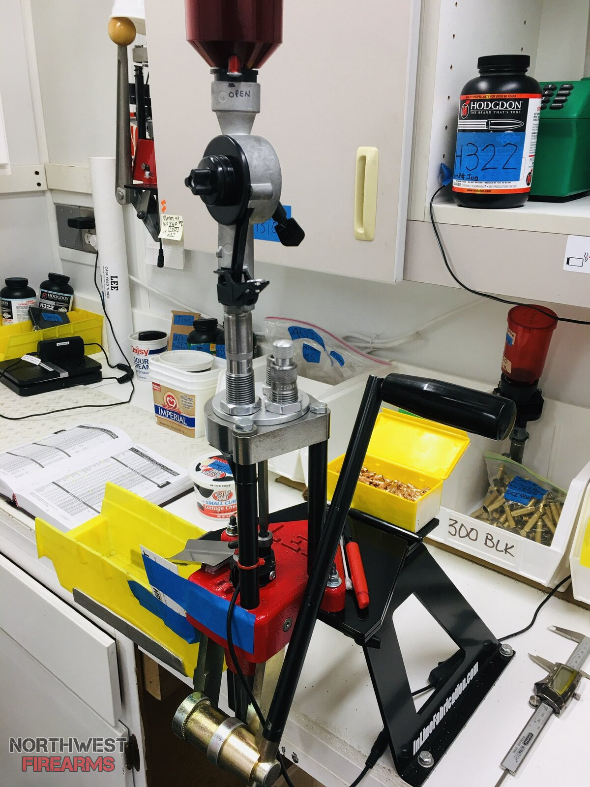

I have a Lee Pro1000, a classic turret and a classic single stage press. Yep, they're all RED!!! :p

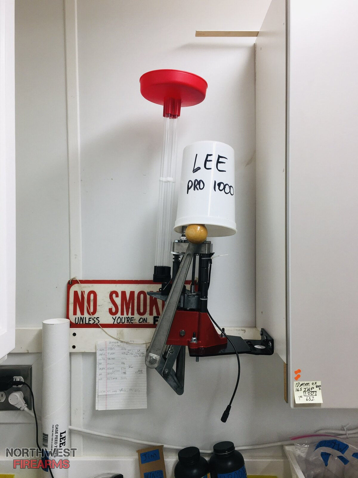

I had the pro 1000 set up for pistol cartridges 40S&W and newly acquired 9mm 4 die set. Being as the Pro1000 is only a three hole progressive I had to do the final phase and crimp on the single stage press, taking up more time and effort to complete one round.
I had the classic turret press set up for 223 and 300 blackout but was not satisfied with the erratic seating depths that I was seeing. The problem seems to be that the turret has so much slop up top that I was having to mic each round. Depending on the measurement I would have to adjust the seating depth down or go to my collett bullet puller (in my classic single stage press 3' away) and raise the bullet slightly then again try the seating depth. It's been a royal PITA
I'll tell ya.
I know, third world problems right. I cannot spend money that I do not have on a better press but I like the ease of changing calibers.

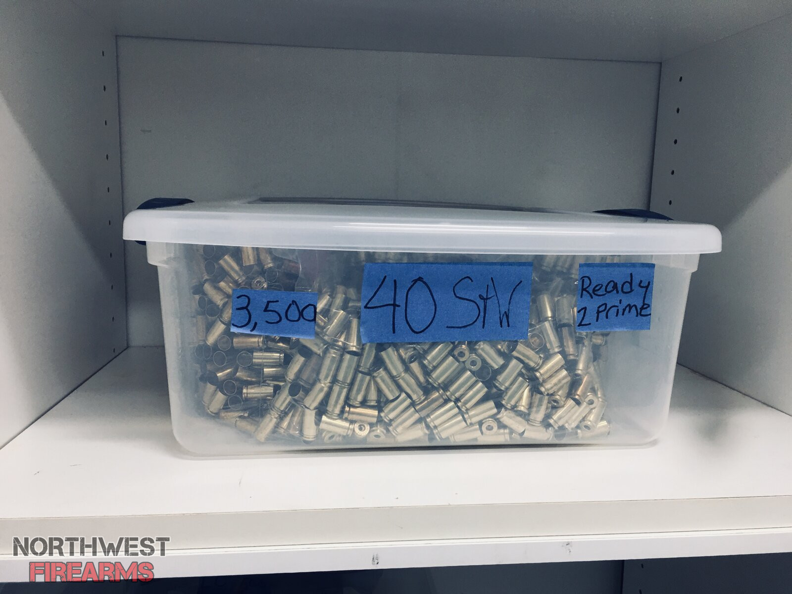

Here's what I decided to do, I switched the rifle cartridge loading to the Pro 1000 since i have the #4 shellplate. I only need three stations anyways, I prep and prime all my brass before they hit the reloading press, pistol too.
I removed the 223 and 300BLK dies from the 4 hole turrets placing them into the 3's and the pistol dies into the 4 holers and adjusted each set.
It took a bit of work but I'm hoping the results will be favorable.
Thoughts?
(besides ditch the cheap setups and go blue)…

The 4 dies in the 4 die press makes sense to me. If you still have trouble with the rifle seating you can do the loading on the 3 die machine and set the final depth/crimp on the single stage. I load all my personal rifle ammo on my Rockkchucker. Yes it takes awhile but it is good ammo hand tailored for each rifle.
My thoughts are, I've never been fully satisfied with Lee products and you're highlighting part of why. They're the cheapest and they give me the cheapest results. Going just ONE step higher has yielded satisfactory results without having to make anything work
Yeah I guess some don't enjoy a bit of a challenge sometimes, that's what Lee's are all about.
I have time on my side so I'll just adjust when needed. The Pro 1000 gives me pretty consistent results with pistol calibers.
I have entertained the thought of a Pro 4000 but I would still have to change out dies and shellplate each time. It might not be so bad since I usually only load 500+ at a time.

I don't resize pistol brass until I'm ready to load.
