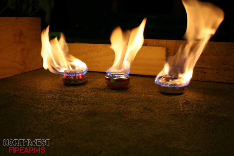

Just a couple of mine:
I'm particularly fond of the one on the right; I used no epoxy or other sealant for that one.
On the store-bought front, I also have a Triangia one - really nice. I had a collapsible titanium one (forget the brand) but it was poorly assembled; the legs were welded on crooked, so anything you put on top of it would be crooked as well. I checked the store and all of them looked the same. No thanks, I'll stick to my home-made ones.
