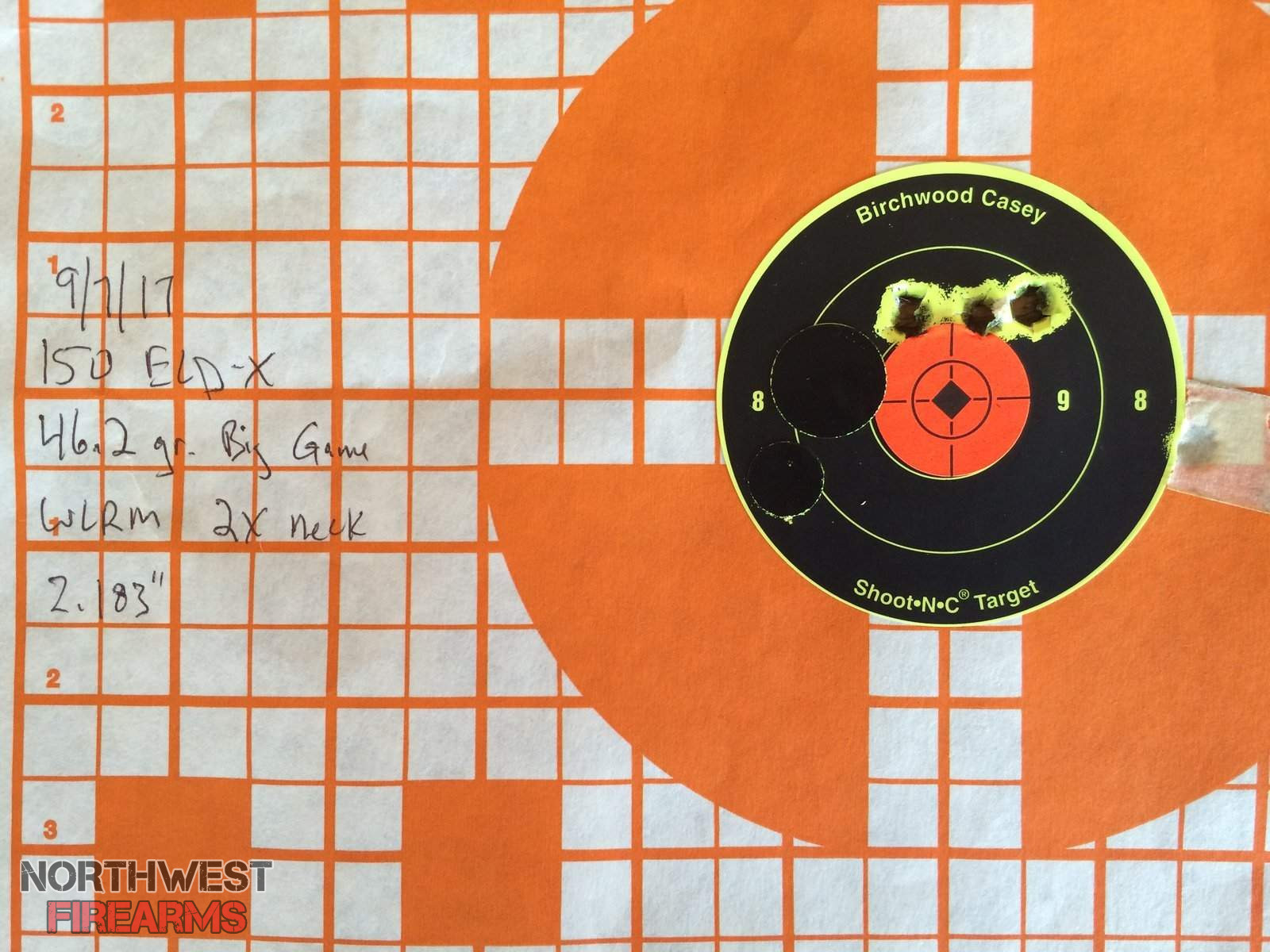

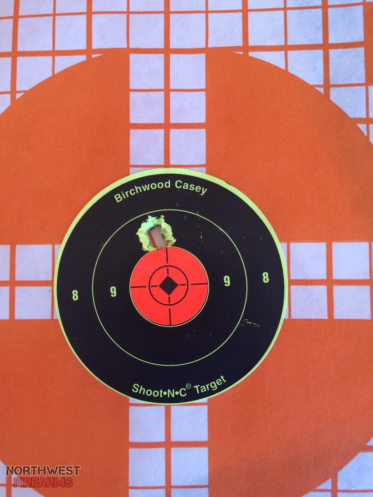

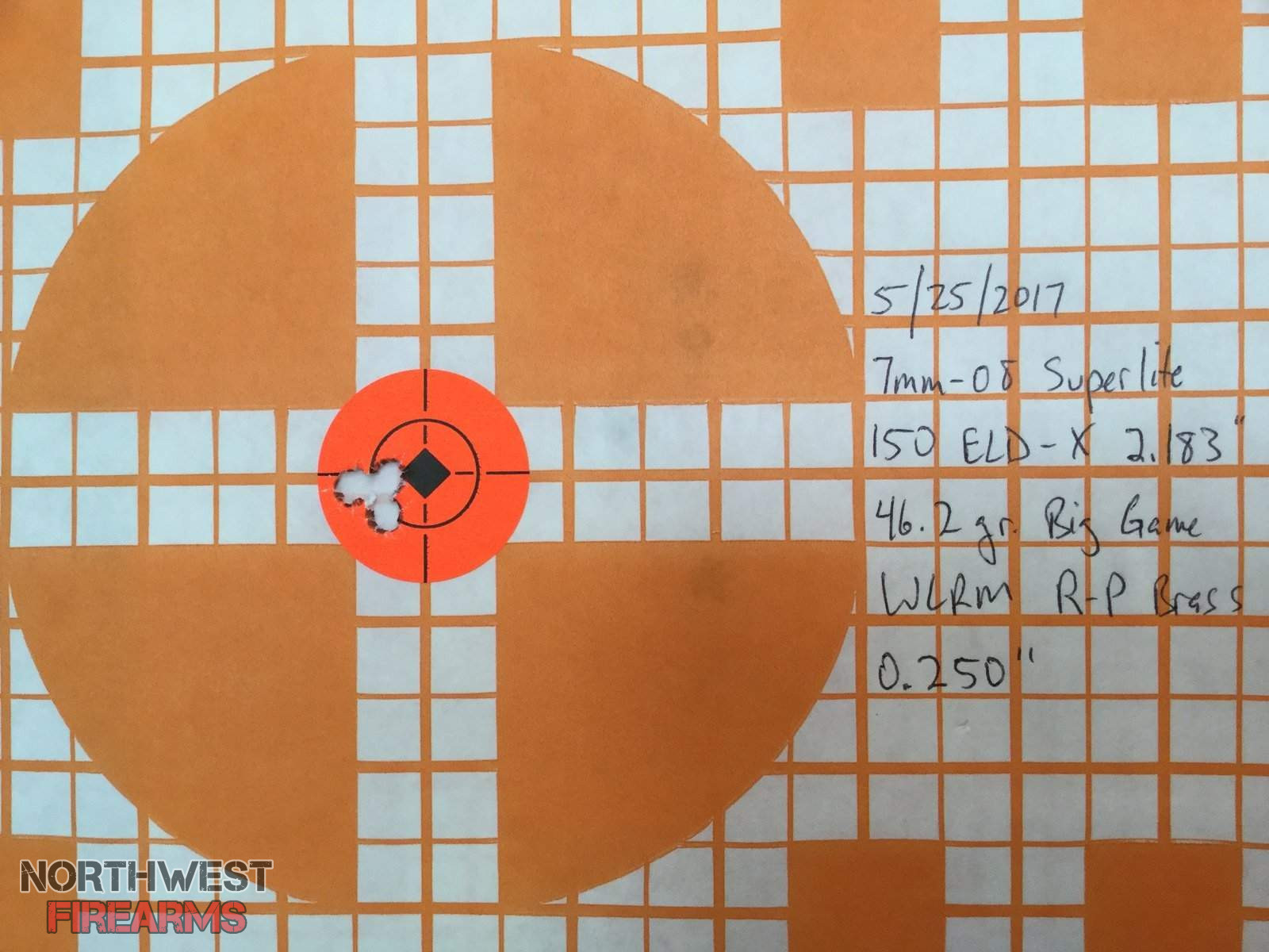

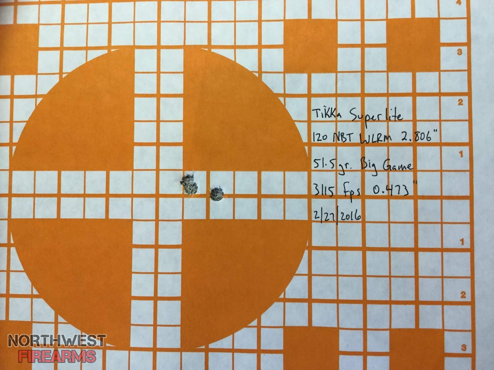

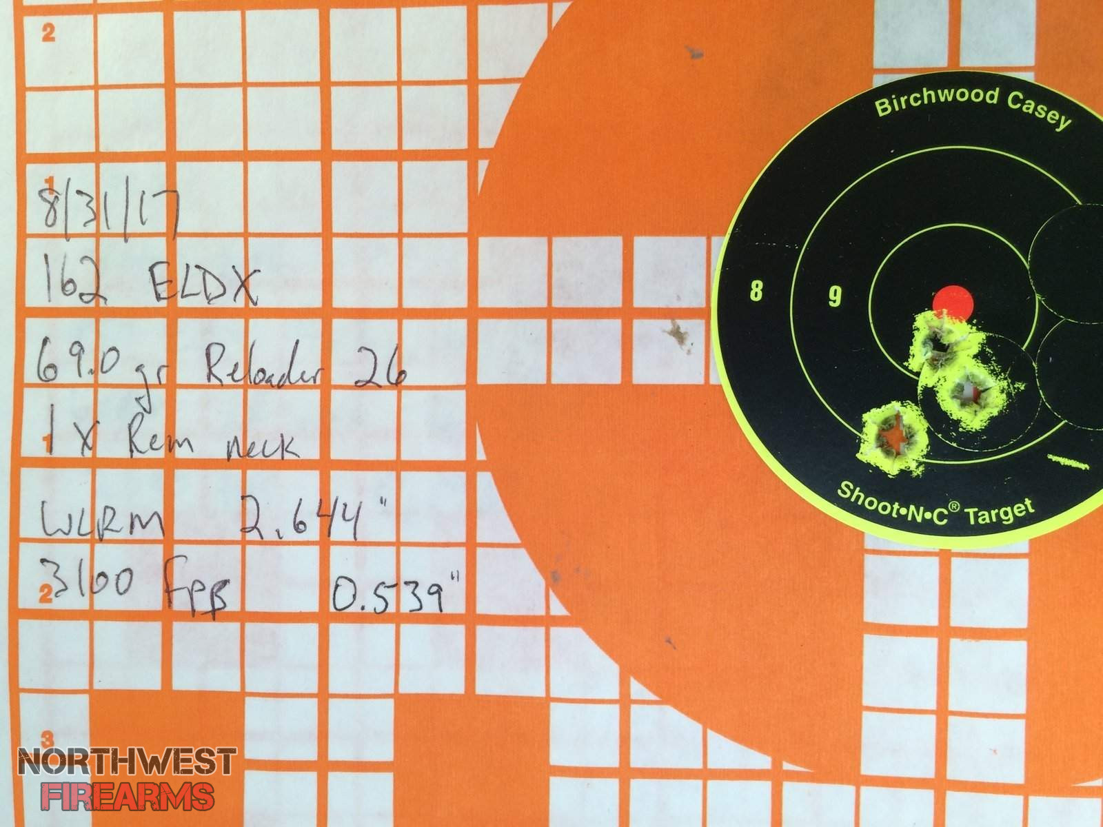

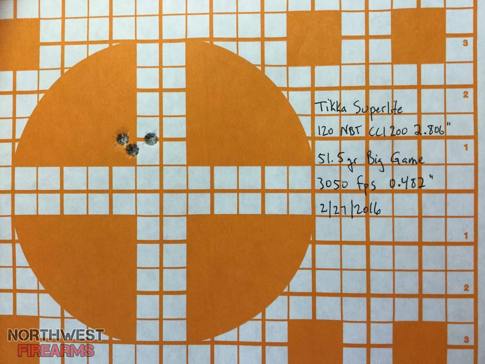

I'm shooting a Tikka T3, so I'm constrained by magazine length. I prefer kissing the lands but that's not an option with most of my Tikkas.P
I'm considering buying my first Tikka. Are you saying you are not able to reach the lands in most your Tikka rifles? I've found best accuracy in most my rifles is when I can seat the bullet into the lands. I don't do this with big game rifles...regardless of accuracy because you can end up pulling out the bullet if you have to remove a chambered round. Still, best accuracy in my hunting rifles are with the bullet quite close to the lands with minimal jump. Just curious...this could change my direction. Thanks for any additional info.
All of these are from Tikkas. None of them are close to the lands.

Yeah, but I included two pics of the same target. I tried to delete it but it didn't take.
