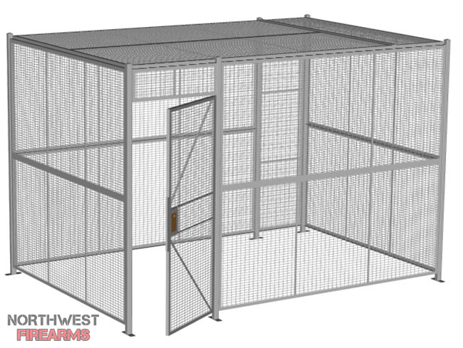

Build one of these in your garage, them just frame in standard walls around it to disguise it. They sell them as a kit in many different sizes.
Foound a few manufacfurers/sellers:
