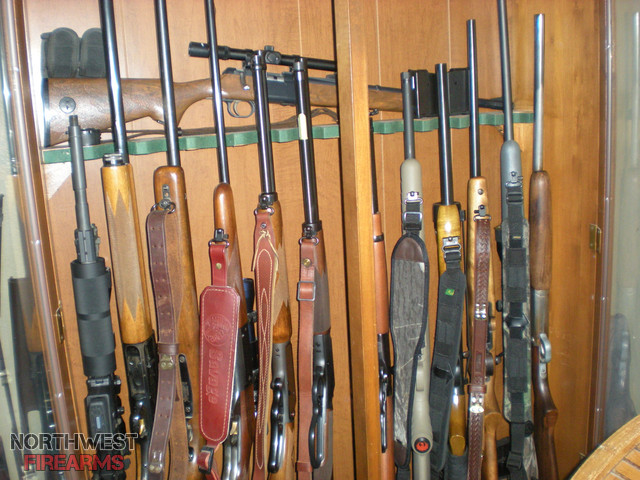

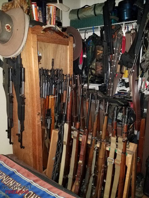

I have a gun room with all the long guns out, on bipods, in racks, stands, or glass cabinets. Displayed in some manner A few are stacked up against a wall on ammo cans. Only the pistols are in a safe. I went with a simple fireproof door and dead bolt in an existing room. Anything short of a vault isn't stopping anyone determined. PAX

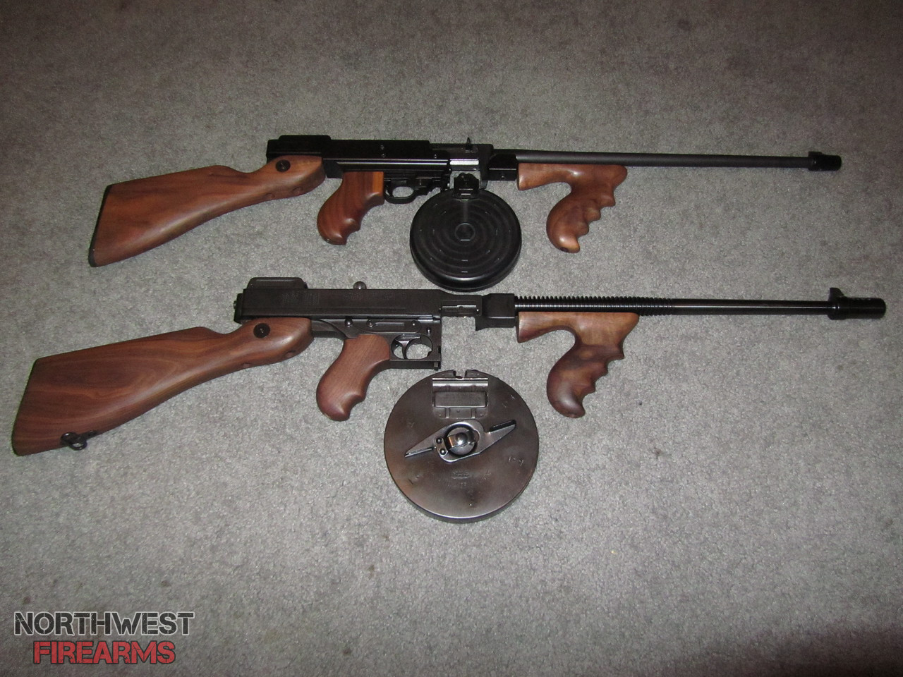

The cream of the crop. The actual Thompsen isn't mine...yet.

Cabinet full of SKSs and a rack of bolt guns

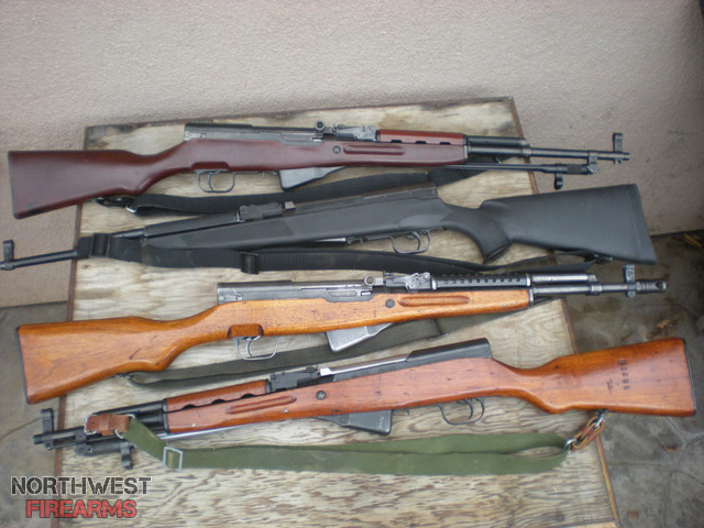

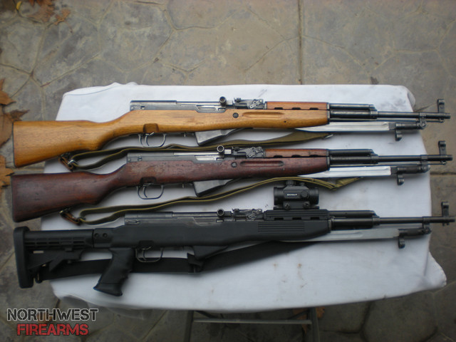

Some of the SKSs I sold/traded last January. Usually on lead sleads or bipods.

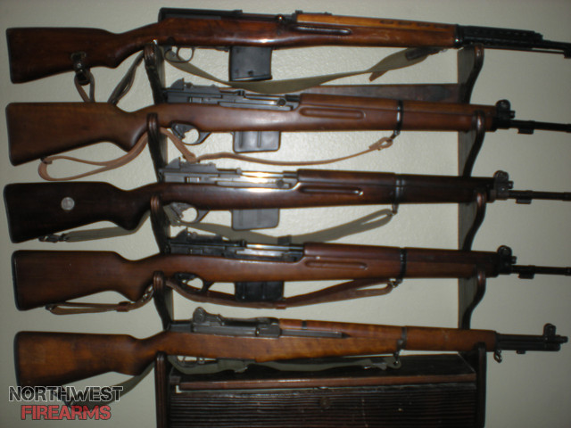

The huntin rigs and my Rossi in the center. Almost hidden by the door stop.

The huntin rigs including a .308 Savage 99F, .30-30 Marlin 30AS, .41 mag Henry and my .357 Rossi 92 in the center. Almost hidden by the door stop. I just picked up another Rossi .357, octagon barrel carbine, crescent butt, case harden receiver. I'm going to put a little bigger loop on. I have a blonde 5-gun rack that the levers will solo in. PAX
