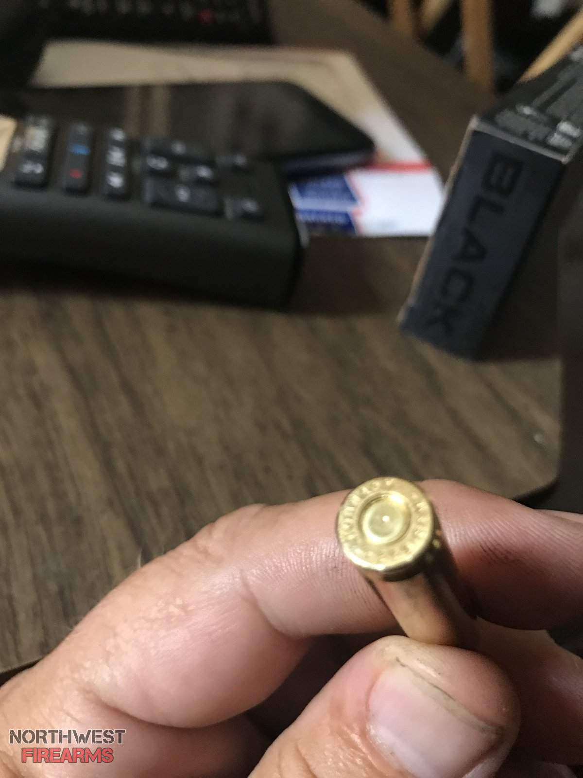

I have just came back from the range. My AR build is able to fire the first round and it picks up the second round but, the trigger is dead. I am curious to know what is going on.
The lower is a Spikes Tactical with a Maxim Defense CQB stock. The upper is my Bushmaster 16" barrel.
I am not sure if it's the buffer or the trigger. Here is a video that may help. Anything else that would help you help me just ask.

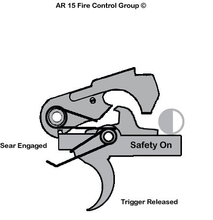

As @Heyjoe pointed out, you can absolutely do this "Dry fire". Standard test after building a lower (before you put the upper on) is to cock the hammer (with your hand), while your hand is still on top, pull the trigger and then push the hammer all the way back down until the disconnector engages it, repeat several times. When you put on the upper, without ammunition, pull the trigger and keep it held down, cycle the bolt, slowly release the trigger until the disconnector disengages, pull the trigger and cycle the bolt again.
If it's failing this test, there may be something wrong with the LPK, it could need polishing or something could be out of spec. The hook on the disconnector may be too long, the slot where the disconnector sits may be too deep, or the hole placement on either the trigger or the disconnector may be off. Either way, this is an essential set of checks to perform on any AR. It is also possible the disconnector isn't engaging, and you're lucky and not getting slam fires.

one possibility is the hammer is not locking back on the sear and just chasing the BCG forward and resting on the firing pin.

What is your FCG? I would remove it and make certain your hammer spring and disconnecter spring are not installed backwards, if they are you correct you most likely have either and out of spec FCG or lower receiver.
